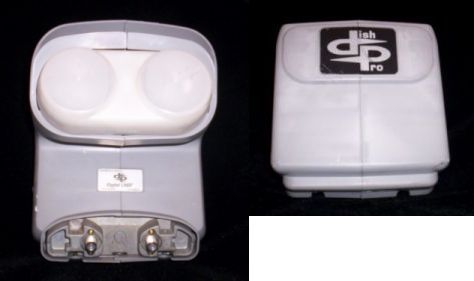

There are THREE (Fat Heads) types of Dish Pro LNB's
Dish Pro Plus (NOT FTA Friendly Mainly Power issues)
Dish Pro Twin (two outputs/outlets)
Dish Pro Quad (four outputs/outlets)
The Twin and Quad are very FTA Friendly and I've tested with Pansats, Viewsats, Fortecs (okay you get my point).

These are DishPro (Twin & Quad) Very FTA Friendly
Any of these will work for you!
