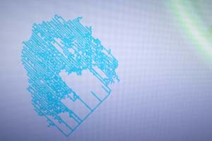

I also have the "road map" problem on my 50" Sony Grand WEGA Proj LCD TV. I bought model KF-50WE610 back on 11/02/2003 from CC. I first had a projection-bulb failure (after only 6 months). Now, after a little more than 2 years (26 months), I have this optical control problem. It looks like a pink/magenta-colored road map. I love the TV overall, but I'm very concerned that so many are having this same problem. It must be an engineering/manufacturing defect. Fortunately I purchased the CC extended warranty (the technician is coming first thing Monday morning -- 2 days from now). I never buy the extended service plans, but I was concerned about the new technology. I'll try to include pictures in my next post.

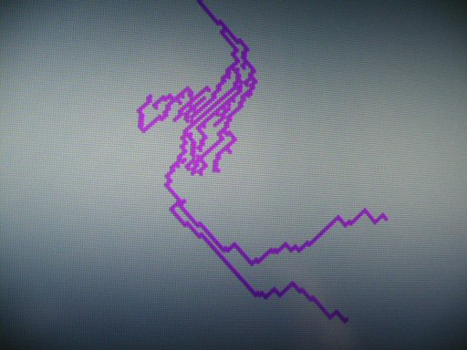

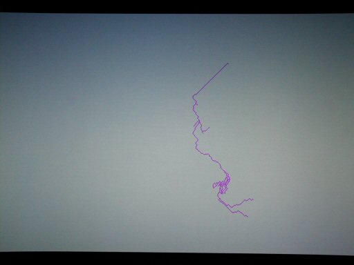

Included below are pictures of my "magenta colored roadmap". It changes shape a little each day, but basically stays in the same general area of the screen. I'll update the board after the technician performs his diagnostic visit in 2 days.

I think he said the tech is making a housecall in 2 days. They will be replacing the Optical Light Engine, wicked expenive repair. Look over this thread and breathe a sigh of relief. Your EW is about to pay itself off about 3 times over if not more. |

Yes, I have on-site service as part of my extended service plan. Though it was expensive, I had gotten an extra 10% discount on top of a sale-price for a purchase price of ~2700 (at a time when this TV sold for $3200 just about everywhere). The extra 10% was given by the CC manager because they had a power-outage the day I was getting a demo of the TV. They also had a rebate deal where they provided me a $300 CC merchandise card (so my net purchase price was $2400 in Nov 2003). I also wrote a note to Sony customer-service to express my concern about this issue.

The in-home service people called this morning. The tech is sick today (or so they claim), and they have rescheduled for Wednesday. I'll provide an update after he visits on Wednesday. One thing that I have noticed is that the "road map" effect changes the longer the TV is on. It starts with a section that has lots of grid lines (looks like a lot of "side streets" for an entire city). The longer the TV is "on", the "side streets" begin to disappear. After many hours of operation, it becomes a long jagged line (looks more like a lightning bolt) as the "large grid of lines" begins to thin-out.

Latest update on my extended Warranty repair. The tech came this morning. It took him about 2 seconds to diagnose the problem -- he says "yup, I've seen this before". Assuming my wife translated his diagnosis correctly, it's related to a crack within the LCD display mechanism. I assume it's a crack in the reflector/mirror itself, since the pattern does change a little as the unit heats-up. Anyway, he'll call once they receive the part. Like everything else, he estimates that it will take about "2 weeks" to get the part and complete the repair. Hopefully it'll be fixed in time for the Super Bowl.

| Posted on Wednesday, February 01, 2006 - 09:49 am: |
Everyone that claims to have a 'roadmap' problem with their tv should post a picture here.....sony most likely pays attention to this website forum as many of you have referred them to it. Sony people see 2 or 3 pictures posted and the rest are just unfounded complaints. Same thing when people call them....you call, you talk/complain, BUT no proof/picture is seen of the problem by the sony person on the other line. Sony really needs to see many pictures of the problem to actually see that the problem exists. Pictures don't lie. Pictures say more than words. Post your pictures!! omarko
| Posted on Wednesday, February 01, 2006 - 08:18 pm: |
Here are the pictures. <p><img></p> |
New member Username: Nowega
Post Number: 1 Registered: Feb-06
| Posted on Wednesday, February 01, 2006 - 09:05 pm: |
Here it is....you need to register to post pictures.....
