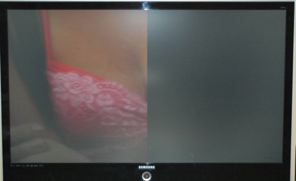

Author Thread: Samsung 6168W 1080P DLP-picture problem
Username: Hoosierdoc

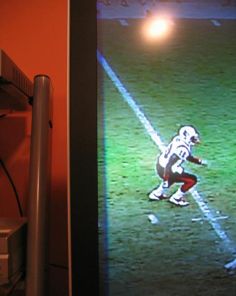

Was wondering if anybody can help me out here. I have had this tv for a little over a year now without any problems. Two days ago, a dark but transparent band has appeared on the left side of the screen only. It tapers to very thin at the top, but it extends about 1 inch when measured from both the bottom and the middle. You can see the picture through the line, but the color looks very funny at the transition point. Any ideas?? Thank you VERY much in advance.

Looks like the shadow of an object in the light path. The lamp light travels through a mirror box. I've heard of a very few of these boxes failing by either coming apart or collapsing.
Call 1-800 SAMSUNG. Get past level one if you are past the warranty period. They usually fix or replace these for original owners, regardless of warranty status.

This problem has been resolved!! It was exactly as FYI described. The mirror box was defective. Samsung sent 2 guys out and replaced it within 4 days of me calling. Cost me nothing, and the TV works great once again. Good luck to you all. Tell them that this is a "known issue" with their TV's and do not back off.

FYI--No my problem is the same as Cliff's in the first post. except my "shaded" band is on the right side of the tv. Same tapered shape too.
Username: Patrickw
Registered: Jan-07
call SAMSUNG, you must have original reciept and fax it to them. Here is a picture of my problem, same as others on this board. My DLP was manufactured in July of 2005. This is obviously a component failure, probably due to bad third party suppliers. Upload

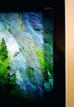

I too have the exact same dark band issue on my HL-R6168W, on the right side, wider at the top (about 1.5'') and tapering towards the bottom.
TV was purchased in August 2005, so out of warranty.
I am currently waiting for a callback from excutive customer relations. Hopefully Samsung will come through on this one. I will keep everyone posted.

I faxed Samsung again yesterday. Nine days now abnd still no response. Here's a photo showing the progression of the problem since discovered 9 days ago.Upload

Phil, it is the Light Tunnel that causes this problem. Samsung was replacing the complete digital engine but now has a bulletin out to repair centers to just do the Light Tunnel. Either part will fix the problem, but the light tunnel is cheaper for Samsung. The repair center must then strip your digital engine to replace the light tunnel (more labor). You must be persistent with ECR to get warranty coverage including labor. If not, you are in for about $200.00 in labor. My set was bought in December 2005 and they extended my warranty to April 18, 2007 to give the service centre time to get the part in case it was backordered.

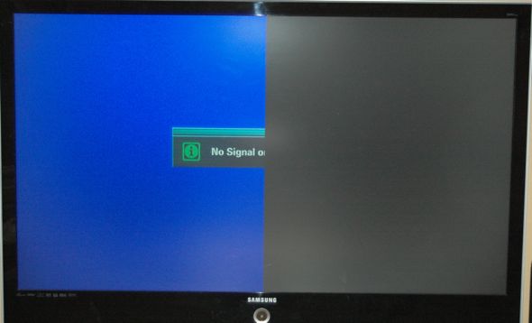

I have a Samsung HL-S6187W DLP TV. The picture will intermittently, as my wife says, just "freak out." 90% of the time it works fine, but when it freaks out, the colors will fracture and bleed, turning mainly green and purple. The images are still there, but the colors look like a bad 1960's psychedelic movie, morphing through the images. If I turn it off, it will go back to normal, but I sometimes have to turn it on and off several times before it does. Any ideas?

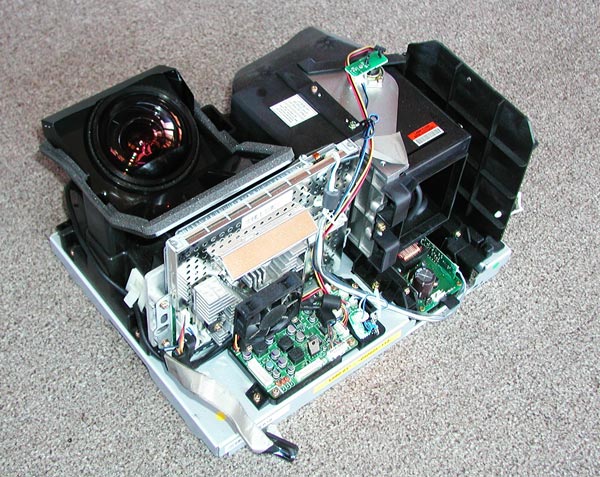

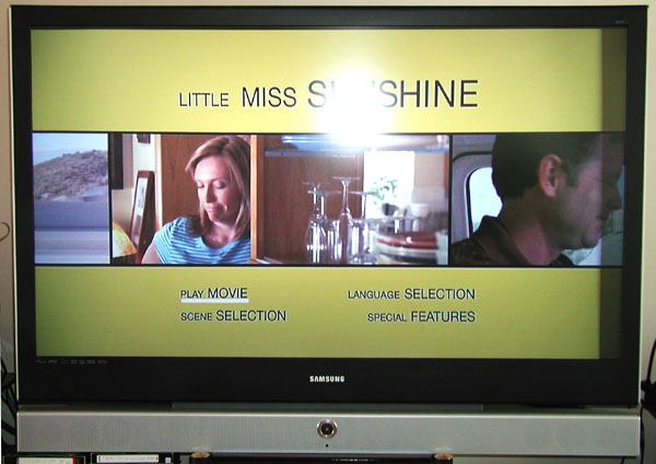

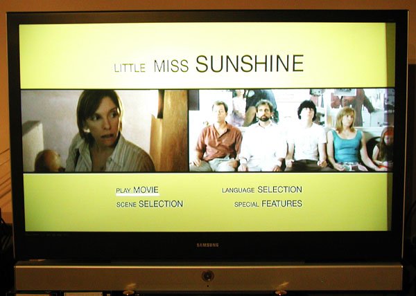

Just in case anybody still has any doubts, all of the shadows in these pictures are due to shifting of 1-of-4 small miror(s) in the Light Tunnel, which is part of the Light Engine.
These mirrors can be shifted back into place by using a soft, narrow, lint-free implement to stick into the hollow tunnel and apply sideways pressure. I don't recommend glue as the Light Tunnel is under pressure and the side mirrors are not (or at least should not be) affected by gravity. Of course you will have to remove the Light Engine and take it apart. I am nobody and I did it in under an hour the second time around. Link to instructions follows.
I do not believe this procedure voids the warranty as it does not make any permanent changes, however you may not want to risk it or waste your time. I would also suggest that if you are still under warranty you attempt to get an entirely new Light Engine as it includes a new DMD, Color Wheel, Lamp and a whole lot of other parts.
If you are not under warranty, you may still wish to get an entirely new Light Engine for the same reason as noted above.
A Light Engine is about $800 and I could replace one in under five minutes! No lie. OK, maybe it will take you 30 minutes on your first try because you will be very careful. You may still wish to pay $250 for a "professional" to spend 15 minutes performing the work as most of them will warranty for an additional whopping 90 days and in some cases this problem has reared its ugly head again within that time period. Others were not so lucky as the latent defect appears to manifest itself a little further down the line.

Here are the instructions:
http://www.avsforum.com/avs-vb/showthread.php?p=10405020&&#post10405020

http://i189.photobucket.com/albums/z50/kaotik78/DSC04410.jpg
Lower left corner, the camera did not do a good job of showing it really but that's what it looks like in a nutshell.
The tech has cleaned the entire unit, mirror, screen, even tried a new bulb, still there.
My solution to the problem is to get a different set.
Username: Brate
Melbourne, FL
United States
Thanks for the pic. I am confident that pattern is not due to a collapse in the Light Tunnel, especially since you said it pulses.
My guess is that your problem is indeed due to a defective DMD and the quote you got for $1000 is for a whole new Light Engine, rather than just the $241 DMD Assembly.
Oddly, this problem resembles a CRT (not the rear projection variety) that is being acted upon by a magnetic field, like when a speaker is placed in close proximity.
Good Luck.

The defective part is called a Mirror Light Tunnel, or Light Tunnel or LT for short. It is a small component within the Light Engine.
Many people have had the entire Light Engine replaced for this shadow problem, which has the benefit of giving you a new lamp and color wheel, both of which have limited lifespans.
The Light Engine was designed to be easily replaced. The LT...not so much. Still it is easily done. 45 minutes is a pretty good time for replacement. I think I could do it in 20 minutes, but I am awesome :-)
The guy about five posts up that gives the part number made a mistake. I am pretty sure that part number is not correct for any model of TV. I think the part number he gives is the Lens Assembly the LT fits into. The only part number I am sure of is for the HLRxx68W series. It can be found here: http://www.samsungparts.com/part_detail.asp?catalog%5Fname=Parts+and+Accessories &category%5Fname=&product%5Fid=BP67%2D00218A
(Notice it does not show the HLR6168W on there, but it is indeed the correct LT for that model...the website ommission is just another quality issue with Samsung.)
There are instructions and pictures on avsforum.com under: http://www.avsforum.com/avs-vb/showthread.php?t=758625&highlight=samsung+shadow
I don't think you even need to buy a new LT. As my previous posts show, you can readjust the mirrors in the LT with a soft narrow implement.

For anybody out there bold enough to open the system up, an interesting exercise is to remove the Light Tunnel assembly (the whole thing with the lenses about 6" long), shine a flashlight through it and project it onto a wall or piece of paper. You will see a rectangular bright spot with the shadow. Try manipulating the mirrors through the little square with a de-cottoned Q-tip and see the results. When you get the mirrors re-alighned and the rectangle clear, very gently re-assemble everything. Very gently...to avoid jarring the mirrors.

Username: Codesloth
Registered: Nov-07
I have a problem which is a bit different. I have lost the right half of the screen:
With input:
Without input:
Any ideas what could cause this or how to fix it without a service call?
Username: Codesloth
Registered: Nov-07
Found an answer in a different thread:
"FYI
Sounds like the mirror box collapsed. Samsung will replace it at no charge."

I will no longer purchase anything Samsung ever again, Like others, before I pay $1K on repairs, I'll buy a Sony and save money.
Username: Joelb
Registered: Jun-08
I have a HLS 5687W and about 2 months after my warrenty ran out I noticed a 3 inch transparent band down the right side of my TV. I called samsung and they didn't want to do anything to help except send somebody out to look at it at my expense. So I said forget it and I would wait untill I had money to fix it after hearing it might cost over $1000. After looking up the problem today I came across this site and called Samsung again. Thank god! At first the rep didn't know what I was talking about untill I started explaining the problem to her and she did remember an artical she read about a similar problem, after looking into it further she found that many are having this problem and told me it is covered by them. She then transferred me to service and they are to be calling in the next day or so to schedual a time to come out and fix it. The repair center mentioned that this special deal is only available untill December of 2009. GREAT NEWS!
Username: Delax
I bought a HL-R5667W in June 2006. It worked flawlessly until a week ago when I noticed a one inch black band on the left hand side. I have a tech from Circuit City due to come over tomorrow to troubleshoot since I purchased an extended warranty. Will keep the group posted on what the tech says. On second thoughts I should have called Samsung and asked them to fix it but I guess I will be satisfied so long as the TV is fixed whether by Circuit City or Samsung. This thread was awesome in terms of information and experiences posted by everyone. Keep up the good work.
Username: Markmc
Registered: Jun-08
Forgot to get back to you guys. The tech had left my set apart until I made a decision whether or not to let them replace the color wheeel. Samsung refused to cover the wheel, even though it had very few hours on it, and they would not let me talk to the tech (who had mentioned to my wife that he might be able to do the wheel for free. I told Samsung to forget the wheel repair (since I knew from this forum that it was a job I could do), that I was fine with just the light tunnel repair, and to have the tech come put my TV back together. When the tech called me to schedule his visit, I told him what had gone on with the Support folks, and he said he could help me. He ultimately took a latest gen wheel out of another broken TV, and installed it in my set. All's well! If i had been home when he did it I would have tipped him $40-$50. WARNING: I think the color wheel damage was done when the set was turned off and then right back on - I remember hearing a sound like a rotating assembly rubbing up against something. When you kill the power, let the TV sit for at least 20-30 seconds before you turn it back on.
Username: Westdc
Ammissville, VA
Registered: Jun-08
I purchased mine back in late 2005 in June I noticed the light tunnel issue, while having other problems, Screen going Green the back to normal color at all times during use.
I contacted Samsung,Complained, they recomenned a service center. They (Samsung) replaced the light tunnel for free, I had to pay for the ditgal board +labor for that, MY set is two years out of warranty. Total repair was $518. The labor and light tunnel was $300 (Samsung) paid that, Thanks to all on this thread for input.
Username: Thecombatwombat
Registered: Oct-08
This thread was very helpful, so thanks to everyone who posted. I noticed this issue last night.
Today, my experience was much easier than a lot of yours. I gave my model and serial number, described the issue very briefly, and the first tier rep immediately said this was a defect acknowledged by Samsung, and they would cover it from an in home service center a few miles from my home.
Haven't scheduled with the service center yet, but total time on the phone with Samsung was under 10 minutes, including hold time. Fantastic. My set is an HLR-4266w.}
Username: Champt02
Registered: Nov-08
My HLR-5078W was purchased in Feb 2006 and the dark strip just appeared on the left side of the screen last week. I called Samsung and they told me it was misaligned. I told the guy that was not the problem and he said a service center would contact me. The service center contacted me about 4 hours later. The owner said if it is the mirror or light tunnel it will be fixed at no cost to me. The repair man comes tomorrow. We will see is Samsung actually backs up the problem. This thread has been very helpful!
Username: Ummlee
Registered: Dec-08
I have a hlr6178wx 61" dlp that I purchased in july 2006, I now have the same dark band on the left side of the screen I thought it might be the lamp so I replaced that and it did not help so after reading the posts I contacted samsung and I am now on the wait list with my transaction # for them to find a service center in my area. I live in rural south Ga UGH sooo they said give them a week to call me back I have my fingers crossed. Thanks to all for the posts it really helped
