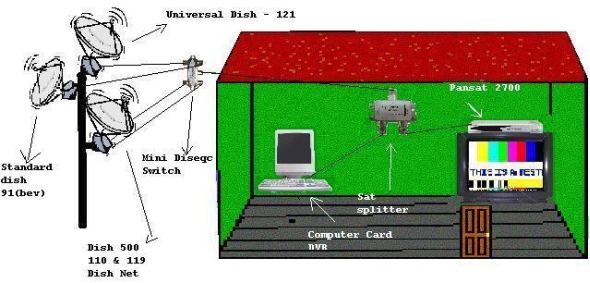

Username: Ryersonresurrected
Post Number: 94
AMT, I have a dish 500, and 2 other dish picking up 91, 110, 119, and 121.....all are connected 2 a diseqc switch...and then connected inside to a splitter that runs to a Pansat receiver and also 2 a dvb computer card. So I am sharing/splitting the signal.
However, either i don't have it hooked up properly, or this is as good as it gets - but i tend to lose signal a lot on the receiver when changing channels and scanning on the DVB card - and vice versa.
There are times when i just can't get any signal at all if it's split. And there are times when i CAN actually have 2 different channels on at the same time...not sure how/why.
i've never been able to split Bev (91)...just doesn't like to be split.
i'd love 2 know the same thing because i've never had it working as well as i'd like. But if ur just using DN, and ur not using both simultaneously, it can work...at least it has for me. Not sure if it's worth all the hassle though.
ATM, this is an interesting question...I would love 2 know if it is possible 2 improve on this as well.
Post Number: 107
Hi bui,
Sorry about that - i tend to do a lot of short form writing (tried to avoid it in the post because of the obvious conclusion, but force of habbit got to me)
* Yes, i meant "to"
* No, not a DVD card, it's a DVB card (FTA satellite card by Hauppauge)
Let me see if i can explain better:
i only have one cable coming into the house. It originates from a Dish 500 (110/119), and two other dishes (one is universal dish pointed at 121, the other at Nimiq 1).
They are all connected to a diseqc switch.
The cable running into the house is the (often times) split in two (i know i shouldn't, but it works sometimes, and i can always remove splitter when needed - i should really get an A/B switch soon, just haven't decided on permanency yet).
Split: one line goes to pansat 2700,the other goes to my pc DVB Sat card.
If I'm trying to pull off an impossible, that would be great to know. I'll decide whether the inconveniences are worth the hassle or not, i guess). But if it IS possible to do this better another way, that would be great to learn as well.
Maybe the A/B switch would work best, is this the only reasonable/possible alternative?
Thanx
Post Number: 127
Does this make sense: Upload
