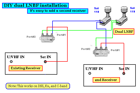

ok i have a pantec and a viewsat extreme, and 2 sats on my roof 119 and 61.5, i want to have both recievrs in different rooms and watching there own thing, like one can watch ppv other can watch international or something, WHAT CAN I DO?
Username: Mc_sunny
Post Number: 326
It is possible if you have enough outputs on your lnbs. You'll need dual lnb on your 119 dish and dual lnb on your 61.5 dish. a regular DiScQ switch should do. you'll need a switch for each receiver.

thanks but how would i install that? do u know a web site where they explain how to do it, thanks
Username: Mc_sunny
Post Number: 327
Shivas thats how i hooked up mine..Here is a diagram for you...i hope this help...Good luck

Thanks alot Mcsunny, i can install it now, greatly appreciated

hey I have a question. What if you wanted to do the same thing that Shivas is doing but with three satellites. Is it still possible?
Username: Bones714
SO.California
Post Number: 65
Registered: Mar-05
Anythings possible, just need another satellite setting then hook up your lines to the diseqc.
Username: Mc_sunny
Post Number: 328
nice diagram
