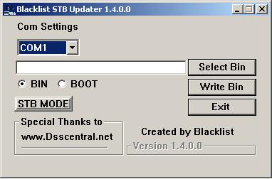

On the loader there must be a STB MODE button, just press it, once u get the right cable it will work...
Username: Nikk
Post Number: 155
You should have a screen like this...

First of all you must press the Select Bin button, browse to wherever u have the bin, after that the blank space will be filled where the path and the bin name, then after have everything connected press the STB MODE button, then press Write Bin...and wait....don't touch anything until you get the message "Complete" and see that your receiver reboots, get the On indication and after that the channel number on the display
