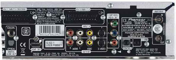

Username: Sonictech
Post Number: 7
Sorry John you're right, the component hook-up is 'out', not 'in'. I have attached a diagram of both the rear panel of my DVR-930 (which you already have) and the rear panel of my PDP-505HDE.
application/mswordUpload
Pioneer rear view.doc (69.6 k)
Pioneer rear view 2.doc (57.9 k)
You will find most of the rear panel of the Sat Hd box at this link:
http://www.digitalspy.co.uk/article/ds33072.html
There doesn't seem to be a better screenshot anywhere on the web for this. All that it is missing is the HDMI connection over to the right.
You now have all the info and specs.
If my DVR is connected to my plasma via component and my HD Sat is connected to my plasma via HDMI, what's available to connact my HD Sat to my DVR? Only Scart!
I'd be very grateful for any weight-in you can provide. I'll keep an eye on this post. Thanks again for everything.
