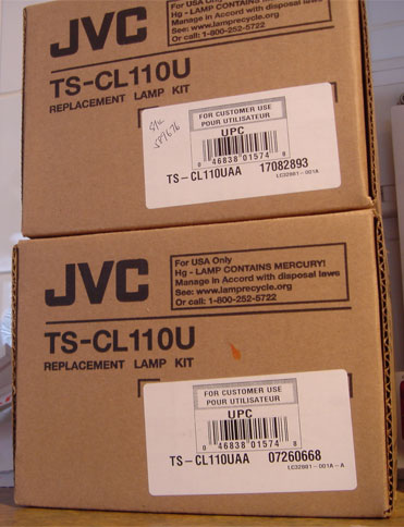

Well, while I was at work I read Doug's message about getting the bulb today and felt a bit bummed as I was still waiting for mine. When I got home, i was surprised to find that the bulb that I ordered through a JVC dealer arrived and as a bonus, I also received my warranty bulb from JVC Canada!
My eyes are now tearing up, not just because both bulbs arrived but also because of how bright the picture is again.
Anyway, dispite the fact that JVC didn't have an ETA for me, I can't really complain about the service once I got through to someone and an order was entered into the system.

Username: Bobka01
Sacramento, CA
JVC has now sent me two replacement lamps, though I requested but one! Each had return shipping materials for returning the recently deceased carcass of the original lamp. Hmmmm! Now what? Just when I thought I might have exhausted any reason to communicate extensively with the troubled masses... JVC drew me into your midst again!
