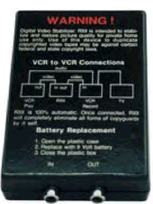

I thought I had mine wired correctly and ready to transfer. I transfered a movie from VHS to DVD no problems. Then I went to transfer a newer one DVD ... this one was a friends; therfore I needed to transfer from DVD to VHS, then I wanted to keep my copy on DVD. The transfer from VHS to DVD went fine, but when I tried to transfer back from VHS to DVD the window saying copywrite material wouldn't allow. What happened?!?!
Here's my equipment:
RCA VHS vr524 VCR
RCA DVD 8060N Recorder
RCA TV
A stabilizer with no name. It says VCR to VCR Stabilizer. Digital Video Stabilizer.
It worked great VCR to VCR. I put in a new battery.
These are all seperate units.
I have the RCA wires, red, yellow, & white that are all together, but I can't understand where they go when using the stabilizer.
I would appreciate info help greatly.

In previous post I mentioned I didn't know the name of my stabilizer, well since, I've found this photo and it's the same as my stabilizer. I found it on the MCM stabilizer site. I'll try to upload a photo.(not to sure on this.)
David or anyone, is this all I need to be able to transfer my VHS to DVD that have copywrite?
Username: Crazide
Registered: Apr-06
I'm tryin to upload a photo of my stabilizer. So someone can tell me if it's the correct type.
Username: Tmax59
Post Number: 10
That's the $29 job that I mentioned above (that I almost bought but am glad I didn't).
David's post at the top of this thread says "DVD to DVD or DVD to VHS is a different story for sure, don't expect the stabilizer to work for that, it might and it might not." So maybe he can help you out. I quite frankly don't quite understand why a stabilizer would work to filter out Macrovision from VHS to DVD but not from DVD to either DVD or VHS. I'm NOT saying that's not the case; I'm saying I don't understand why it is.
I've been using my ancient VCR as a stabilizer and that works both ways no problem.
I didn't understand your post above regarding your setup and what you were trying to do, so perhaps you might try to be a little clearer about it?
It sounded like everything was working fine from copy-protected VHS tape to DVD. Then you tried to do a copy-protected DVD (your friend's) to VHS. Then you said "The transfer from VHS to DVD went fine" and that's where you lost me. Did you mean to say "The transfer from DVD to VHS went fine"?
Because it sounds like you had a friend's DVD (copy-protected) that you wanted to have a (DVD) copy of. And so you transferred it from DVD to VHS and then tried to transfer it back from VHS to DVD (your copy). I assume you were doing it this way instead of transferring it directly from DVD to DVD because you don't have a 2d DVD player to connect to your RCA DVD 8060N Recorder (thru a stabilizer, of course).
Bad idea. Transferring to VHS first is probably going to result in some loss of video quality, not to mention that it's an unnecessary extra step. Just borrow your friend's DVD player and use it to make the transfer directly.
If I am correct about what you tried to do, then maybe you just forgot to reconnect the stabilizer properly after making the VHS copy? You need to change the "In" and "Out" leads after making the VHS copy (from DVD) because then the VCR is the player (the source) and not the recorder.
And the DVD is now the recorder and not the player (source).
Anyway, that's my guess. Assuming I understood what you were doing.

David...please help me. I've read those all the posts, but am still not sure I purchased the right thing. I went and bought this item on ebay. http://cgi.ebay.com/ws/eBayISAPI.dll?ViewItem%26item%3D9718041245
I asked the seller if this is what I needed to tape Disney tapes. I told him that I had my VCR hooked up to my tv, and then my DVD player hooked up to my VCR. I can record home movies just fine, but get the copyright thing (like everyone else on Disney movies!) when I put in a Disney. This guy told me that I needed a Gen 2 stabilizer, that this one wouldn't work.
Can you tell me if this is what I need or if I need to pay this guy another $20 for the Gen 2 one he says I need?
And can you please email me at kaiyadog2020@yahoo.com I'll be at work by the time you email back.
Thanks SO much for your help!!
Username: Samijubal
Post Number: 2554
Registered: Jul-04
Are you trying to record VHS to DVD, or DVD to VHS? Any stabilizer should work for VHS to DVD. DVD to VHS is another story.
Username: Kaiyadog
Registered: Apr-06
Hello again David. Thanks for getting back to me.
Were you able to go to the ebay auction page and see what I purchase? I am wanting to put my Disney tapes into my VHS player and record to my DVD. I can record home movies just fine, but can't record the Disney movies because of a copyright thing.
I purchased this thing on Ebay, but the guy tells me that it won't work. That it's just for VHS to VHS and DVD to DVD, but in reading some of your other posts, you say that it should work just fine.
Should I go ahead and use it, or should I pay another $20 more for the Gen 2 this guy says I need?
Thanks again for your help!!

David....I hooked up this stabilizer just like you said (and the guy I bought it from) and it still says 'protected content'. Is there something different I can do? I was told this Generation 2 stabilizer was what I needed to copy my Disney tapes, but it doesn't work. And I've tried several different Disney tapes of different years. If there's something different I could do, I'd sure try it!
Username: Kaiyadog
Registered: Apr-06
OH MY GOSH guys!!! I don't wanna curse it and say I got it working, but I think I got it working!!! sssshhhhhhh....I'm not gonna say it too loud and jinx it! :-)
I've actually got a Disney tape in there (The Little Mermaid II) and it's taping, didn't bring up the 'protected content' at all. Now...I'm afraid to stop it and check to see if it's actually recording on my DVD, that'll have to wait until it's done playing, so I won't know until morning when I come and check on it. (Since I'm off to bed now.)
Anyway...thank you all for your help, and I'll let you know in the morning if it all worked....so the rest of you who are all trying to copy Disney tapes like I was will know what I used and where I got it so you all can get the same. I know it was a cheaper one then some of the ones I saw advertised. I think I got this one for $40.
I'll let you all know. Thanks again! (My KIDS thank you all too! You don't know how much they're going to LOVE this!)

Username: Kaiyadog
Registered: Apr-06
Hello again everyone.
To answer your question on what I did to get it working. The Gen 2 stabilizer I bought came with a yellow cable. When I hooked it up the first time I just used the cables I already had. For whatever reason, it didn't work, which was when I wrote the first time asking for help. I went back and for the heck of it tried taking my cable off and using the one that came with the stabilizer, though it was the same as mine, I figured I'd try it. And that worked. So...whatever using the wire that came with it did...that's what worked.
At least it's working!! Yea!!

Hi David,I found the input line and tried to copy a VHS tape to my DVD last night and all I could get was a message Insufficent Video Signal.The DVD said it was recording but was black or blank.
I put a new battery in the Stablizer and still get the same message. The VCR is an Emerson could that be the reason or do I have something connected wrong. Thanks again, Linda

I hope someone can help me.I tried to copy a VHS tape to my DVD last night and all I could get was a message Insufficent Video Signal.The DVD said it was recording but was black or blank.
Username: Samijubal
Post Number: 2622
Registered: Jul-04
You probably have something connected wrong. Connect the 2 RCA audio cables directly to the recorder in from the VCR out. Connect the video out of the VCR to the in on the stabilizer, out of the stabilizer to the in on the recorder. If the recorder has more than 1 set of line inputs, make sure you've got it set on the right input. If the TV is connected to the recorder, you should be able to see what you're trying to record.

I have the GoVideo VHS Player, the NoName Stabilizer, and the Toshiba D-R4SU DVD Recorder Player. I have the connections correct because I can record broadcast TV but I still get the copy protect message when I try to record Star Wars: The Empire Strikes Back. In fact, all copy protected VHS. I thought for sure, purchasing the Toshiba Recorder would solve my problem, so far, no can do. Can you help an old man who is technicaly challanged.
The Toshiba manual doesn't, of course, explain how to by-pass copy protection, so the manual really doen't help. Jim
Username: Samijubal
Post Number: 2625
Registered: Jul-04
Does the stabilizer use a battery? If so is it good? Maybe you've got a defective stabilizer. The video connections should be, out of the VCR to the in on the stabilizer, out of the stabilizer to the in on the recorder.
Username: Jchurch43
Denver, Colorado
Post Number: 14
Yep, connections are as you say. I even reversed them just in case they were wired backwards. The stabilizer came with an A/C adapter so batteries are not a problem.
Username: Samijubal
Post Number: 2627
Registered: Jul-04
I'd have to guess you got a bad stabilizer or adapter.
Username: Jchurch43
Denver, Colorado
Post Number: 15
Suprise. As a last ditch effort, I decided to try something rediculous. I put the stabilizer between the dual deck VHS and a single deck VHS, then hooked the second VHS to the original Emerson DVR. I recorded Star Wars & Jesus Christ Superstar. No problems & excellant quality on the copy. Go Figure.
Username: Samijubal
Post Number: 2630
Registered: Jul-04
At least you got it to work.
