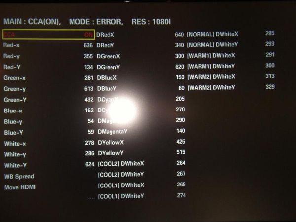

I have a Samsung hl-p5067 and the CCA settings have been changed. I had a listing of all the factory settings in the service menu but ( I swear this happened) my dogs ate it. Anyone out there have a listing of these factory settings. CCA and COEFFs? thanks

It's dfferent for each light engine. When a light engine is shipped to a tech to replace a bad one the box includes a data sheet with values specific to that engine.
Here is a snapshot of one before tinkering, but use it for comparison or ballpark.

thanks alot that helped alot. You wouldnt happen to have the DNIe settings also? Im not sure if they were messed with, but the numbers look funky. Thanks again, I've searched everywhere for this info!
