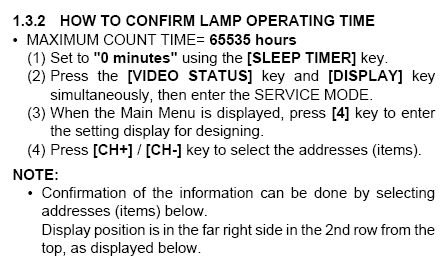

matt crownover - how did you get to the service menu to check lamp life - please share for everyone's benefit. This will eliminate guess work on "hours used".
Thanks

As far as I know the JVC does not have an hour counter for the lamp. It has a timer that counts down from 4k. When the timer hits zero you get a message that the bulb may need to be replaced.
I've been all thru the Service menu and I have not seen anything that has to do with the lamp usage. I wouldn't mind being wrong however...

I think people are getting the Z and the G series mixed up. I've read some posts (and it's in the G series Service Manual) that there is a way to check both the run time on the current lamp, and (I think) the total run time on the set.
If you notice matt crownover has the "G" series (HD-52G786)

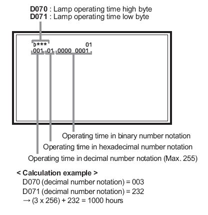

WeAreNotAlone69,
I followed your instruction to determine 'current lamp total run time'. Went into SERVICE MODE menu...no problem. I don't know what to make of the results though. Here's what I got.
D070________00
000 00 0000 0000
D071________5D
093 5D 0101 1101
I just replace the lamp about a week ago. Can you make a calculation determination from this info. D070 came up all zeros...so I don't know how to work the calculation, much less understand it or where the other numbers come from. Does it mean that I have 93 hours on the replacement lamp since installation?
Thanks in advance.
Username: Muleskinner
Saint Charles, Missouri
Post Number: 8
Registered: Dec-05
Maybe I just figured this out
D070________00
000 00 0000 0000
D071________5D
093 5D 0101 1101
(0 x 256) + 93 = 93

For reference here is what I found in another post on getting into the service menu.
The Z series does not have bulb life - I pressed all numbered keys and did not get anything meaningful
4.3.2 HOW TO ENTER THE SERVICE MENU
(1) Press the [SLEEP TIMER] key and while indication of"SLEEP TIMER 0 MIN." is being displayed, press [DISPLAY] key and [VIDEO STATUS] key simultaneously, and the SERVICE MENU screen of Fig.1 will be displayed:
SERVICE MENU
1. ADJUST
2. SELF-CHECK
3. I2C STOP
** Select the SERVICE MENU ITEM
(2) When the SERVICE MENU is displayed, press any key of the [1] to [3] key to enter the corresponding menu mode.
** Select the setting ITEM & SETTING VALUE
(3) Select the service item using the [FUNCTION (up /down)] key.
(4) Set the value using the [FUNCTION (up/down)] key.
(5) Press the [MUTING] key to memorize the adjustment value, If not to do it, adjustment data is not memorized to the memory IC. And if exit the adjustment mode before memorize the data, the adjustment which your changed value is canceled.
4.3.3 HOW TO EXIT THE SERVICE MENU
Press the [MENU] key to exit the SERVICE MENU.
