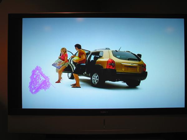

Add one more victim to this group. Bought my 60" KF60WE610 on 11/22/03 and it just started with the grid pattern on 10/10/05. I bought the extended warranty through Circuit City for $599.00. I dreaded buying it because it was the most expensive warranty from any of the retailers at the time. Thought about cancelling several times because everyone says extended warranty's are a scam. For once it's paying off. Called Circuit City warranty department and a local repair joint scheduled an appointment for two weeks from now. Not to happy about the two week delay but I'm sure they put the paying customers first.

I am having the same yellow spots problem with the KF50WE610 I bought about 1.9 months ago. The spot appeared suddenly about 3 weeks ago and a Sony technician told me by phone that for sure it was the "optic module". Mine is out or warranty. I hope Sony will stand behind this product and offer an acceptable deal for its customers.

I have a friend that had the same problem with the road map of lines. He contacted sony and they agreed to let him trade it in for a brand new model for $600.00. His TV was 2yrs old and had no warranty.

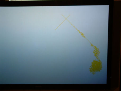

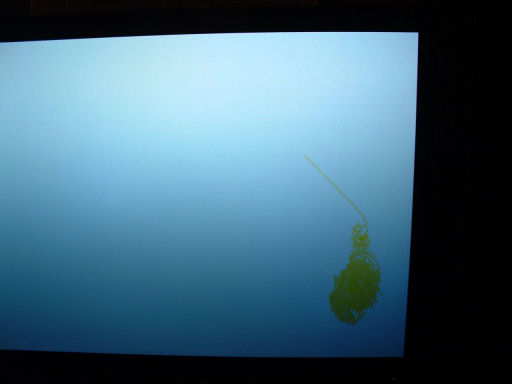

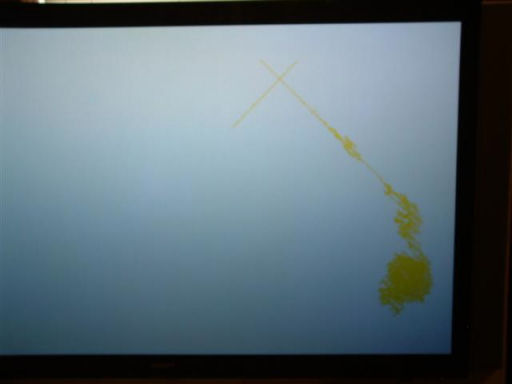

Username: Villanman
This is how it changed after a week. Top pic is when it first reared it's ugly head, Second pic is a week later before it went to the shop. Upload

Make sure you reference this website to let them see the pictures. It helps. And make sure you get to the second level support people...... I got my TV back afer about 10 days after starting the whole process. I am actually pretty happy about all it considering everything.

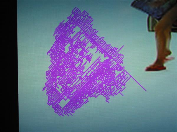

I've got the same problem with my KDF-60WF655. It is an irregular yellow lattice (criss cross) pattern in the bottom center of my TV, and it looks just like the pictures other people have included. I've had the TV just under a year, and just saw the problem yesterday when I turned the TV on.
I do not subject the TV to excessive temperatures or use. In fact, I really don't even touch the TV at all.
I called an authorized SONY dealer to ask about the problem, and the technician told me he had seen this problem before, and performed the necessary repair. He said that the problem is a defective LCD panel, but that in order to repair the problem, the entire optical assembly must be replaced, which costs $1500.
I am still concerned that the new optical assembly might suffer from the same problem at some point down the road, but the technician assured me that the defect is rare. I got lucky that my failure occurred within one year, but if this new optical assembly fails I'm sure I'll be angry like most of you.

Update:After 3 weeks in the shop waiting on the part, I finally got my TV back fixed. Again I'm Glad I got the extended warranty because this time it really paid off. The receipt total was $1543.15,
$1187.49 is what they charged for the light engine/optics block.

My KDF-50WE655 came down with the same yellow spider-web problem a couple of days ago. It is a big blotch in the lower, right-hand side of the screen. Luckly, I have owned the tv for less than 1 year and am still under warranty. I called Sony and it was pretty obvious that they recognized the problem. The service center just called me and he said that they know the problem and are just ordering a new optical light engine, without even looking at it. They seemed very helpful and said it should be fixed within a week. I'm just hoping that this is a one-time issue and won't reoccur.
So, Sony (and its service centers) definitely know of the problem and hopefully will take care of it for anyone who comes across with this particular issue. This forum has been very helpful in allowing me to diagnose this problem and get it fix (hopefully) so quickly.
