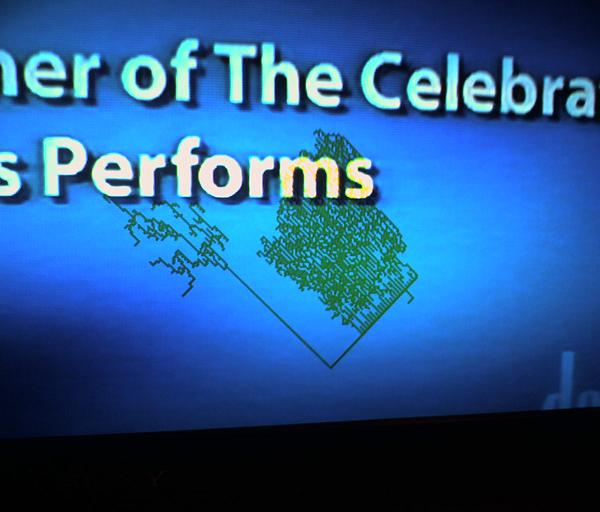

I have a Sony KF-60WE610 LCD Projection TV. I have had it for about 1.5 years. I turned it on tonight and I noticed these strange yellow lines. Any ideas?

Same thing with 50we655 but much bigger print of the yellow. Still waiting for sony to do something set was new on christmas
Username: Waazzuup
Registered: May-05
It's actually worse now
Username: Hillboy
Registered: May-05
Mines bigger than that :-) and it is growing. Sony has no tech in our area and I am still waiting for them to cal back. Are we the only two with this problem

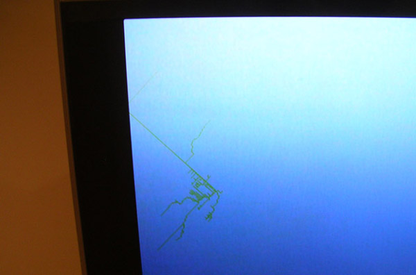

Odd, My sony 50we610 which is also 1.5 years old
came up with the same defect 2 days ago. Same type of pattern on the lower right had sign. From
posts on other sites looks like the LCD and not the screen. Not sure how Sony is going to convince the consumer this is expected for a set

Ok - My extended warranty came in handy. The guy came out yesterday and said he had only seen something similar to this one time before, but it was with a Hitachi. He thinks it's a problem with the light engine.
I don't know exactly how it works, but the repair company somehow works with sony. The repair man said he was going to let sony know what's going on with my tv and they will decide if they want to try to repair it or if they will just replace it.
Username: Waazzuup
Registered: May-05
By the way...
If you have this same problem, please post pictures. If we can show that this is a common problem, maybe sony will do something for people that aren't under warranty.

My Sony 50WE610 which is 1.8 years old
has the same defect. Same type of pattern on the lower left quadrant. Out of warranty. Sony Customer service suggested that it was a normal occurence. I am very unhappy at the moment.

I have a SONY KF-42WE610 1.6y old. No problems up to 7/1, turned set on 7/2 same yellow etch-a-sketch likemarkings on lower R quadrant. Anyone get resolution or answers from SONY?

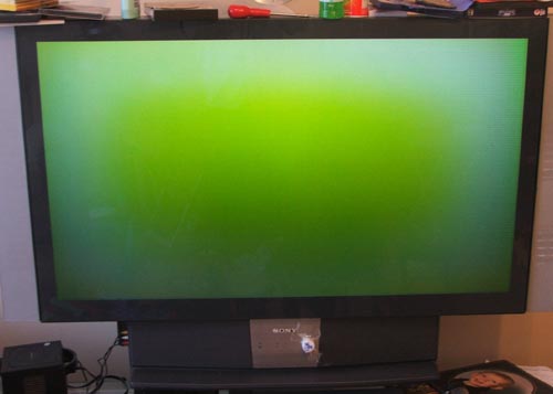

This page came up first on google, and it is exactly what appeared on my tv (KF-60we610) last friday. Talking to a service tech today, I had difficulty describing it. He asked "Does it look like a road map?"
"Yes!"
"It's your optical assembly. Costs $1800.00"
I asked him how many tv's he's seen this on, and he told me he's only seen three do this. He claims it's a rare occcurance. I countered, that, after being on these forums I think it's more widespread. No, he said, these forums are loaded with fake posts designed to make sony look bad.

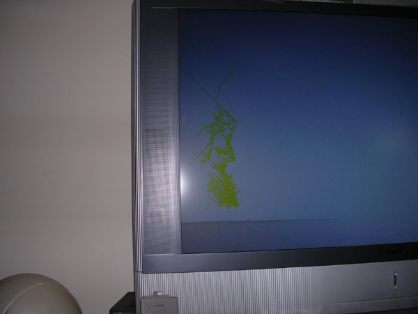

I just have this kind of problem, bought it about 2 years. I'll u/l my photo.

The second one began having green circular spots a couple of inches in diameter. New light engine is what they told me which is the cost of the TV practically - it was under Sony warranty.

I have a KF-50SX100U and have recently found a yellow patch in the middle of the screen (and maybe growing) but I don't have the lines that you guys do, just a big tinted patch that you only really see against white backgrounds. Is this related to the same pretty much unfixable problem that you guys have? I replaced the bulb to no effect :-( Looking at the pic I just took, it looks like most the screen is affected now so it will just be a case of playing with the color/contrast controls to negate it across the whole screen, but if it is fixbale without spending huge money that would be preferable.

I actually managed to find my warranty and thank god I did actually purchase the extended warranty on top of the ordinary which covers it with Mastercare whereby if they can't fix the problem they have to give me a new but comparable TV.
When I phoned Sony about the problem they didn't seem to have a clue. However when the Mastercare guy turned up he phoned his office and someone there said it was the optical block, that Sony have admitted the problem and that Sony offer the replacement part for free as it is a recognised fault.
Mastercare have now taken the machine to put in the replacement part so its waiting time now.
As for the 5 years, seeing as the TV is only actually turned off from 11pm till 7am and is on the other 16 hours a day EVERY day thats a lot of hours and yes i consider 5 years a long time for a TV, if nothing else I'm usually ready to replace the TV for a newer and better one after that amount of time anyway (and this one is too big to put in the bedroom which is where the previous TV usually ends up).

Same exact problem here, sorry no pic as I've had it repaired... Similar story though.
Bought my Sony 50WE610 2/28/2004 (floor model from Sears for under $2000) Added 5 yr warranty for additional $400. After 1 month, did not work had bulb replaced under warranty(4-12-04). No hassle and worked fine until about two weeks ago when I got the same pixelated yellow line roadmap you guys have described. Been almost exactly 1 1/2 yrs since purchase (plus however long it was used on the floor.)
Called for service, first tech was an idiot, but with phone support diagnosed it as a "light engine problem." (Cost $994.50) They shipped me the new part a few days later, and a real tech came out and installed it in less than 45 minutes this week. (Labor $239.00) Said he hasn't seen this before, but he's a Sears guy, not from Sony. Worked great when he left.
2 days later, will not turn on. I can hear the click, then green light blinks 4 times, followed by an orange/yellow blink, then three reds. No picture... Any help on this one? Also, any progress on getting Sony to acknowledge this/recall sets/class action suit?
Nice to meet you guys, will be back on here checking the status of this increasingly obvious problem. I love this set when it works. Great picture, especially for HD sports broadcasts. But there are obvious problems, and I'm not sure I can recommend buying it unless you go with the longest warranty possible.

To brigopens: The service manual lists the self-diagnosis codes, and indicates that when the light blinks four times, it is reporting a high temp defect, either one of the fans isn't working, or one of the boards isn't properly connected. It doesn't look like something the homeowner ought to be trying to fix on his own, though.

Well, well, what do you know. We have the same problem with the yellow road map on our 50" screen. Obviously, its a defect that Sony will have to answer for, especially when there's strength in numbers. Everyone should keep putting on the pressure to them by calling the district office, threatening to post editorials in newspapers and calling the technical support people. We left our tv on for 4 days straight and most of the lines have disappeared but this is a ridiculous ritual to do and who says is won't reappear? I wonder is the price drop is due to the fact that Sony is aware of this problem?

i have a Sony kf-42we610 that is 1.75 years old. it has a small greeen patch that is visible when the screen is white. it is annoying but usable. yesterday i noticed small green pixels lines that are about 2 inches in length. i dont have an extended warranty. is sony liable for parts to replace this? thanks

This is a defect with the KF-60WE610 television that I have experienced too. There are three lenses in the television, each with a different primary color, and sometimes those lenses will burn causing the discoloration.
Unfortunately, you have to have it serviced.
I got my TV at BestBuy and bought the service plan with it... after the one service call about 1.5 years after purchasing the TV, it has paid for itself.
Username: Strongstyle
Registered: Aug-05
Got my TV back from mastercare today. When they came over they said that Sony were replacing the faulty part free of charge, but on the receipt of repair it has the Optical Block being listed as £450. Either way, i payed nothing and the TV seems to be 100% again and Im happy :-)

I have the 50 inch model and have the exact same problem; yellow lines looks like a map of city streets or something, lower right corner. The tech that came to my house told me it was the "Optical block unit", and it needs to be replaced. $1000!
The people at Sony say they have no record of this being a recurring problem. Typical.

42" wega lcd one year six months old. Yellow lines similar to a city map appeared on left side of screen. Any helpful suggestions.

leave your tv on with any tv channel until all the lines disappear. then turn off for one night and the tv should be back to normal the next day.
