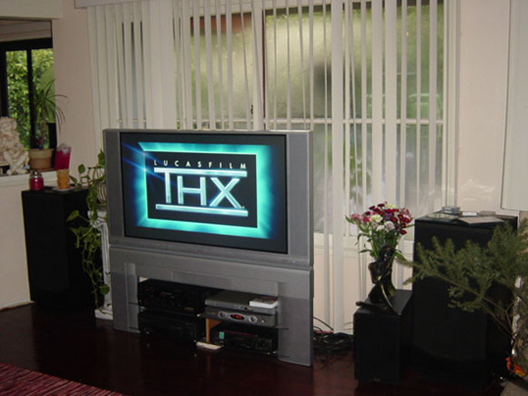

This is my rig.
Note the support pannel between the shelves. I still didn't get a quote for sturdier glass.

EA.. Nice clean set up!
I wish my amp and MCE PC would fit on the shelves, but aside from being too weak, they are also not deep enough. I'm thinking of replacing the stand all together but that's no easy task (since this stand matches it so wel).
