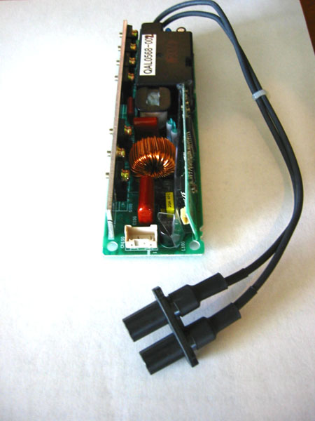

Update on the repairs. The tech was not able to fix the unit with the Service Remote (Remocon unit). So he ordered the JVC DVI module to fix the problem. Not happy right now..So with the service Remote we were able to get the HDMI to work but then it would turn off after a second or two, so the module is needed. We will wait for the light engine install after the DVI module part is in, and do it all at once.
The service remote is a Remocon unit. This is what he did to reset the HDMI. First set the Remote code to 03-C6, then...to reset HDMI, hit the number(3). At that time the HDMI would work but would not stay working. This is all I know for now.
I have a picture of the new Ballast part being upgraded. The tech said, what they have upgraded is the Boot, and the clear plastic strip that was added for protection on the board.
