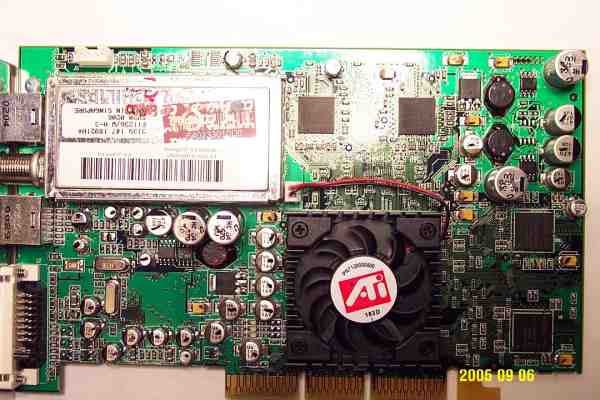

Picked up what looks like an older ATI card, there is a chip on the backside marked ATI RAGE Theater...(chip on second picture below near DVI output) Card has a COMPAQ part number on it. Appears to be new as there is no dust on fan.
Since it is probably NOT one of the newer cards that adapter sounds interesting...
Looks like I need to hunt around on the ATI website.. see what it is... see if the drivers will support the card. Have the card, a breakout box, a usb remote pickup, a ATI remote, a DVI cable, S-Video cable.... Got a good deal on it, so maybe it could be used for something (if not for the JVC)..
PS: Thanks for responding, and the info /tips!

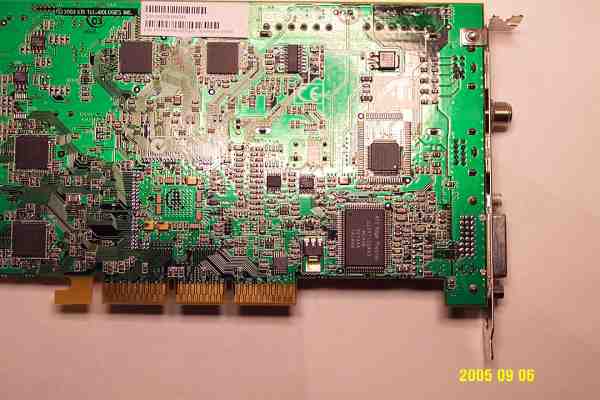

Username: Wearenotalone69
Post Number: 37
Registered: Aug-05
Bobo,
According to the serial number it's a All-in-Wonder RADEON 8500 128MB DDR AGP NTSC.
Bios 11383601102
Part number of board: 1028360300
What board are you running?
