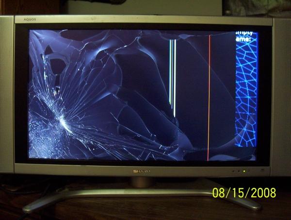

My LC-45GX6U is suffering from a problem I haven't seen discussed in here, yet: there are four bands of faint color, two near the top of the screen and two near the bottom, especially when the screen is blue. I've still got three weeks or so left on my warranty. Any ideas?

Username: Eng2007
Registered: Aug-08
Hi,
If anyone is interested I have a working Sharp Aquos LC-32DA5U for sale with a broken LCD screen. I believe, from research, that parts are compatible with the smaller lc-26da5u and i think they will work with lc-32d4u but please confirm. Please private message me, I am located in Toronto.Upload
