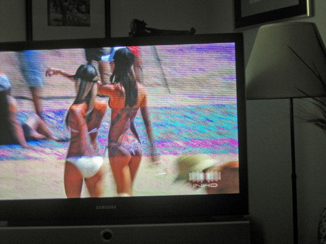

I have a brand new Samsung HLR-4266W bought thruAmazon.com for me as a gift and delivered to my home July 27,2005. My cable company connected it all up with their digital and HDTV service the next day and for nearly 30 hours, it all worked great and I loved the picture. But then, a big problem occured. I got very strange broad horizontal bars of very noisy interference over the screen which cleared up after a while and then a lot of seeming random red noise occured only to return to a great picture for a while etc.
I called Samsung for service help and after saying that the set was too new to have much of a service record they scheduled me for warranty service with a service provider who actually has an address in my hometown. The problem is that the provider doesn't answer his phone and I can't seem to get anyone at Samsung to help me get an actual date for service established. I have an official Samsung servce ticket number, but that doesn't really let me do anything except find out that it has been assigned to the service provider they list---maybe since he doesn't answer his phone I can't be sure.
Now what? has anyone a suggestion as to how to actually get Samsung warranty service on a brand new but mal-functioning supposed state of the art DLP HDTV? By the way, here is a picture of the actual problem if anyone might have had a similar one plese let me hear from you.

Very interesting picture...in more ways than one.
It doesn't look like a set problem to me.
It looks more like a cable signal problem.
I haven't read that you have tried a different signal source like a DVD or VCR player.
Is it happening on all channels? All inputs?
What type of connection? Cables?
Have you taken the cable service line straight to the tuner input on the set, bypassing the box?
This looks like ingress of off-air signal from a loose fitting on the cable line. Did you contact your cable provider to investigate?
Intermittant picture distortion is almost always signal related.
Garbage in...garbage out!

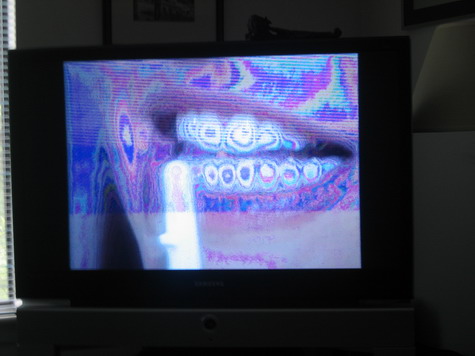

Yes, I have tried it on all channels, both HD and standard, and when I switch to a dvd source ( through a s-vid connection) I got the same sort of pattern. My cable box is connected through component video connections. I have tried making sure all connections are tight too. I suspected the GI-GO possibility and maybe still do.I also suspect thet it could be heat related since it comes, goes and then comes back but less so.
Perhaps I will try the direct cable input to the set and see what happens. Here is another off of the set picture showing another form of the problem

It's most likely the video board since it's happening on different inputs. A very rare occurrance, but it sure seems set related.
Call 1-800-SAMSUNG again, prompts 2 then 1 then 3 then 1 and tell them your ticket number. Then ask for the Executive Customer Relations Dept. and tell them your designated service technician is non-responsive and ask for alternative action. These folks are very good at resolving problems.
