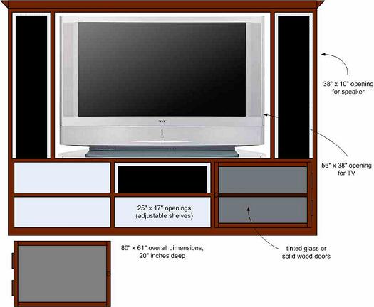

Bronze Member Username: Chrisinyork
Post Number: 22 Registered: Dec-04
| Posted on Tuesday, January 04, 2005 - 02:46 pm: |
Thanks Andrew... I wonder why it converts it back to analog component video. Weird. I have decided on buying this set. Now I just need to design and build a new custom entertainment center to fit it. Here's what I'm thinking about...
New member Username: Andrew_debbie
Post Number: 4 Registered: Jan-05
| Posted on Tuesday, January 04, 2005 - 03:29 pm: |
That looks great! Looks like you have left enough room for ventilation. The owners manual says to leave 4 inches open behind the set. The fan is in the center near the bottom. The remote sensor is in the uppper right on the front. There are channel and volume buttons on the right hand side at the top. I've been studying the schematic. It looks like Sony didn't have the time to redo the digital part of the set to directly work with the HDMI signal. Instead they convert the HDMI back to analog componenet video and feed it into the same analog switch that is used for the other inputs on the back of the set. I think they just wanted to get the feature into the set so it would be compatible with HDMI cable boxes and DVD players. |
