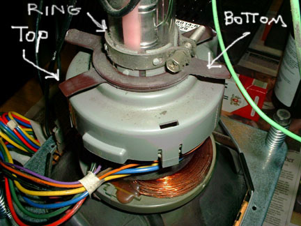

Need help finding out which adjustment on this CRT yoke controls horizontal tilt.On plain
I know that the two controls on photo....marked top and bottom ,control up and down and side to side. But I need to know which one controls the horizontal on plain. By any chance is it the grey locked ring on the yoke ? Need help
Jayz Upload

Loosen the screw on the grey clamp and rotate the yoke. Leave those tabs alone. Do not move the yoke in or out on the tube neck or you'll screw with the purity.

First I would like to thank you for your quick responce, But before I do this,I need to know if this is indeed how you control horizontal on plain. You never said directly. Thanks again
