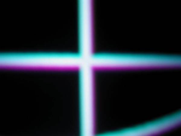

>> The covergence was now TERRIBLE everywhere but the center of the screen. More than 2 pixels as you went out the edge.
>> you can fix that in the service menu.
Mr. Lynch ..
You were very helpful when I got my JVC, so I wanted to let you and everyone know something about the TV's.
Yes, you can adjust the convergence in the service menu, but this is only for the center of the screen.
JVC MAKES NO WARRANTY ABOUT CONVERGENCE OUTSIDE THE MIDDLE 1/3 OF THE SCREEN RIGHT/LEFT and TOP/BOTTOM.
I talked with a JVC engineer about this before returning my TV. "These are consumer TV's", not professional and convergence being off up to 3 pixels is satisfactory. It is only guaranteed at the middle." he chided me.
He explained that the 3 chips are basically hard installed relative to each other and since their individual images are projected so far, it is nearly impossible to have convergence across the entire screen. You can digitally "shift" the pixels of the R,G,B individually by 1 full pixel, but that will only fix the one area of the screen (usually the middle).
You can see this if you put an alignment grid up. This picture is when it was "good". After they replaced the light engine it was MUCH worse being as much as 4-5 pixels off (and they broke my HDMI input).
The D-ILA really is really more similair to a 3-gun CRT than the other RPTV technologies and thus should have the same controls inherant to do a proper alignment.
So, when JVC says that there's no alignment to worry about ... I guess that's true in that the alignment is what it is and there aren't the normal 3-gun controls that allow you to align the image across the entire screen .. only the middle.

DonM,
I am not sure where you live, but if you are on the West Coast, you cannot go wrong with Video Only in WA, OR and CA. I bought the all black 61in 61Z786 for $2636 and a 5 yr warranty including bulb for $185. You have 30 days to return if you keep the box and other packing materials.
I absolutely love mine. The CA is about 1 pixel, there are no bad pixels. The entire screen is uniform in color with a gray screen background as a test.
I think this set is the best going. I read this thread since the Fall of 04 and thanks to everyone's posts and especially Mr. Lynch's input I purchased the HDTV and am so glad I did.
