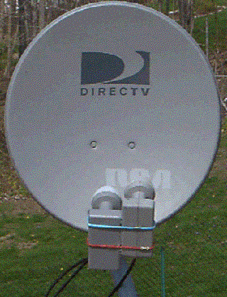

You can make a PoorMans dish to pickup 110, 119 very easily.I've been going that way for over a year. Boots

Upload This is a picture of a PoorMans dish 110 is in the middle with 119 straped to the right slightly higher( facing the dish) than 100. using a Diseqc switch, to switch back an forth between them. Boots

boots very unique way liked the idea

It, works. set up over 30 of them just like that.cheap way to do 2 sats with one dish. an yes I'm from the south. But if you do your homework there is all kinds of ways to set up dishes.This is a weel know setup seen on many forum sites. try it you'll like it. Boots

Upload This is also a great setup, did it for a friend a few months ago. Notice the tupperware. lol. It's to protect the switch and connections. that was his idea. Boots

thx for showing me the picture so that I could understand how to do it.
