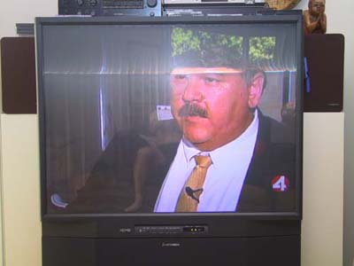

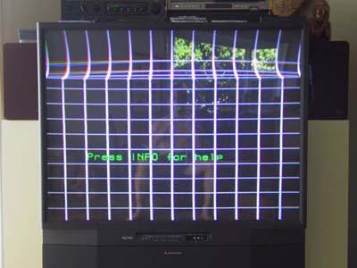

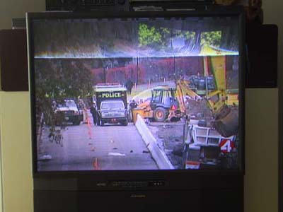

myl mitsubishi 50" has suddenly gone wacky. if you know what is wrong with the t.v. and can recommend a tv repair person in the s.f. bay area who makes house calls, or whether this is a REPLACE instead of a REPAIR, please email blinde@5happy.com

Looks like a three dimentional grid from the service menu.
Nice reflection of your windows and curtains on that glaring Mitsu screen. I see you sitting there too! You might consider placing the set on the window side of the room facing in.
You don't have a small button pushing child do you?
That's a bizarr test pattern!
Have you tried unplugging the set for a few minutes?

Plus I can see major convergence errors too, it maybe a simple fact, look at the manual, for troubleshooting.
If all fails there maybe a dry joint on the PCB or a IC that’s malfunctioned, if that is the case the cost will be quite small.
grfunk
Unregistered guest
Bad capacitor or capacitors in the deflection circuit. Easy to fix if you're a tech. Shouldn't cost much.
