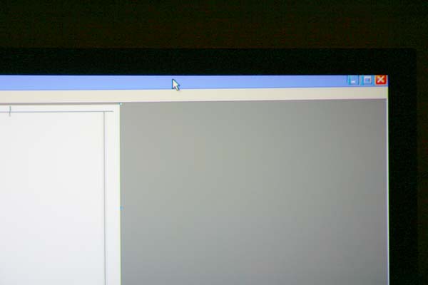

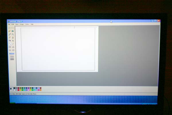

Username: Dave_decoste
Registered: Mar-05
Here is the tilt issue I explained earlier. Does anyone else see this on their ILA? It is noticeable also with a widescreen DVD with the black lines on top and bottom or with sports tickers. etc. Is this fixable or should I return the TV?
Username: Nuclearfish
Nashville, TN
Post Number: 42
Registered: Feb-05
Dave, try setting the cable box to 1080i
As I said earlier, this fixes the problem.
scott

Dave Decoste-
Your tilted screen is an easy fix. A service tech will have to do it, but it only involves loosening a couple screws and re-centering the projector. How do you have your PC hooked up to the set? It Doesn't look like you have much over scan either.
Registered: Mar-05
"How do you have your PC hooked up to the set? It Doesn't look like you have much over scan either. "
I have an older desktop with a Radeon 7500 card with a DVI port. I connected a DVI to HDMI cable just to better show the tilt on the screen. There is some overscan but I did not take the time to load the software to fix it yet.
