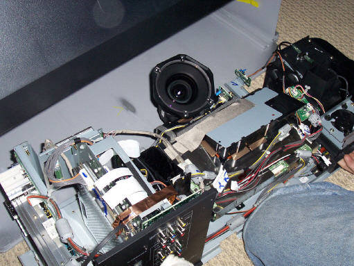

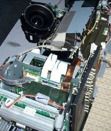

My pics are too large 1200x900, when i shrink them their bigger than 100kbs, whats your e mail i will send it to you...

Send pics to jsarda383@aol.com, I will try to resize & then post pics. Are all the problems corrected with the new chassis? Do you see any improvements in the picture

I have a question about "The new light engine inside the old framework". Was it in a TV case? Or inside an internal part of the set? I was just wondering if JVC has a bunch of the TV cases laying around or something. Maybe someone who wanted a 585 but has a 575 could get the blacks pieces.

It was a new chassis, inside a protective framwork, inside an old TV case (just the bottom).
After thinking this over somemore, I am wondering why the tech brought all of that to my appt....(weird)
JUAN SARDA-
Did you get my email of the pics?

dennis eric halfpenny, here is your Chassis

Try Again, dennis eric halfpenny, here is your Chassis

Mr Lynch, Can you elaborate on the service menu? Like, do the changes make huge differences? What are the most important ones to change, etc? And is it hard, can I screw up the set?
Username: Mr_lynch
Seattle, WA
Post Number: 460
Registered: Sep-04
Rick-
If you don't hit "muting" on the remote, any adjustments you make in the service menu will not be saved. You can play around in it, then turn off your TV and it will go back to it's original settings. Before messing with anything, print out the service manual and right down all your setting (page 21) They will differ for every set.
Some of the changes you can do are very easy and can make a big difference.
The CENTER POSITION ADJUSTMENT is easy to do if your TV is off a bit. My set was slightly cutting off the bottom of the CNN crawl so I adjusted the screen up 3 pixels, and to the left 2 pixels. I used an AVIA test pattern that shows a grid type thing with markings. It made centering my image very easy.
The CONVERGENCE ADJUSTMENT is also very easy and helpful. It is limited in the fact it moves the entire screen 1 pixel at a time, but you can correct any slight " edge blooming" you might have.
Those are 2 of the simpler adjustment that you can make without worrying about screwing your set up.
Adjusting the drive values can also be extremely helpful, but it is deeper into the service menu and you can really throw off your set if you mess with the wrong fields. When I get back from vacation in 2 weeks I'll post some good info on making adjustment in the service menu.
