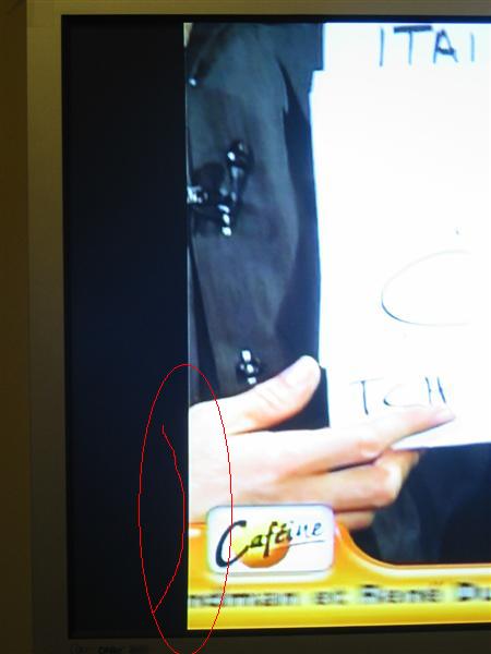

Samsung model #PCL5415R, Year: May 2002
Tonight my husband pulled our Samsung projection TV out from against the wall to experiment with wires to eliminate a 'hum' sound. That was resolved, however, once back against the wall and turned on it has a single distinctive red line in a loose "U" shape across the top of the screen, and distortion under the "U" with more red and image ghosts. Thanks for your help!!!";

In response to the previous post about an upside down/reverse image, I just had the same problem after 3 days of use, with my HLN5065. I left a message for the Samsung service people and am hoping for a quick response tomorrow. Love the picture, but this forum scares me. This TV is gorgeous and I want to keep it, so I hope a quick lamp or fan repair will do the trick, and we'll move on. A month of repairmen coming back and forth would be a nightmare...and did I make a mistake buying a 3rd gen. model from Sams Club instead of the newer one for $500 more?

Username: Jacou
Registered: Jan-05
Hi, thanks to all for the information provided in this thread, particulary the information regarding the fix for the audio delay (the fix worked on my HLN43651W1AX).
I bought the HLN4365 at Futureshop last weekend for a very good discount (2000$ CDN instead of 3300$ CDN). I understand that this is an end of line model and this is why they are dumping the price. I bought the 3 years extended warranty from FS and I also have a 30 days no question refund possibility. Jury is still out wether I'll keep or not the tv.
I have the following questions (btw, first language isn't English so it might not be as clear as I would like)
1) When I use the 4:3 mode (regardless of the source), on the side of the vertical bottom half of the TV, I can see that the line is not totally a line but more of a curve. Although it is not a big problem, now that I know that it is not perfectly a straight line, I have a hard time forgetting about it when I'm watching TV... Anyone else has this problem? (see picture attached). Is there a way to fix this? Would a technician be able to fix this?
I guess i could be refunded but CDN 2000$ is probably the max limit I want to spend on a tv and as such, I tought that the HLN4365 was a good deal. As far as exchanging it, i guess that it will be hard to find another one as I believe that Futureshop has liquidated all their stock.
I someone tells me that he sees the same curve and that it is normal, I will be happy and keep the tv.

Jacou:
I have an hlp4674w and notice the same curvature. It is very slight and only noticeable in 4:3 mode. My thought is that it may be the screen itself bowing inwards slightly or else a spherical distortion from a lens.

Jacou,
I just purchased the Samsung Model HLP5085 and am having the exact same problem as you. I also purchased an extended warrenty from the store I purchased it from (Which is Best Buy). I gave them a call, and they told me that this is a pincushion effect, which a service technition can fix rather easily. My recommendation would be to give either Samsung or your local store a call and I'm sure they'll be able to fix the problem.
Username: Jacou
Registered: Jan-05
Klauss and New 5085: thanks for your quick reply. I'll call samsung to see if a tech can fix it.
Now I just have to check (confirm in fact because I've been playing for a couple of days at halo2 without seeing any out of sync problem between video and audio through receiver) that I don't have the Audio out of sync problem when playing Xbox and I'll be very glad with my DLP choice.
gyb
Unregistered guest
Just purchased the 5085 and am very pleased. I do have a very slight pincushion which I understand is common. I would like to know if I could adjust the green a little bit in the service menu, anyone know how to do that?
Also absolutely no sync issues with xbox thru component cables!
