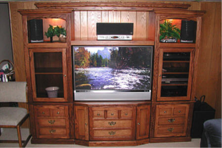

"187" ... Since you asked, this is for you! Here's a picture of our new Toshiba 44NHM84 that we got last week. This is an actual live picture (using the "freeze" mode)...
My wife and I couldn't be happier, but I think she likes the new entertainment center the most. ;) We're hooked-up to Comcast with their new HD/DVR box that allows us to record up to 60 hours of programming (like a TiVo). Still can't believe how awesome HD looks! In the Seattle area, we have around 13 HD channels, 90% of 'em being the ones we watch. In the 5 days since coming on-line, neither of us have seen the rainbow effect, although I did see them on a Samsung 46 during my TV shopping.
Overall, I am very pleased with my choice of the Toshiba 44NHM84. fyi

Thanks for the pic DMILL :-) Your entertainment center looks really slick !!!!

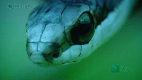

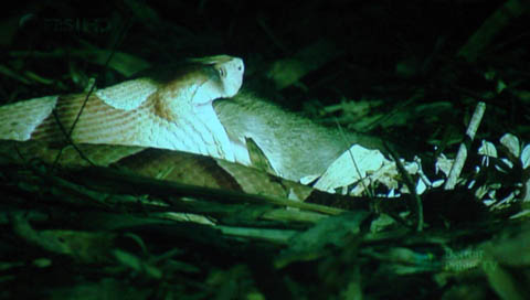

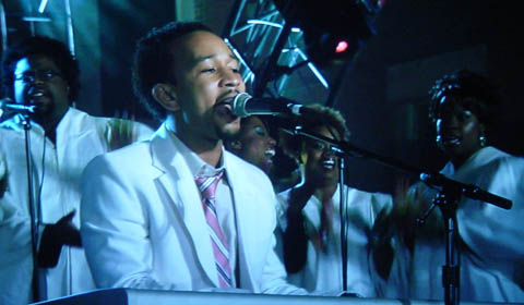

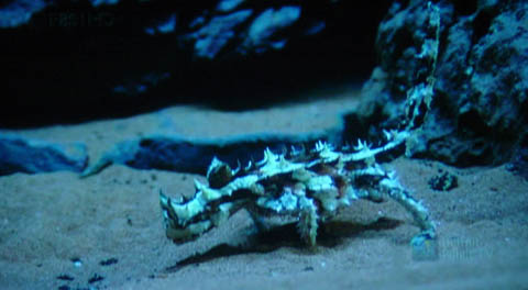

After reading about all these doubter's complaints. I felt like sharing some pictures of what my 44" dlp looks like after all the service menu adjustments from the good people of this forum. Thanks guys for fixing my TV. Mind you my digital camera sucks so these pictures look much better then they depict.

Skotte, I see your point if your not satisfied with the picture then you should return it. I will agree that the Sony LCD does have a better SD channel quality.
