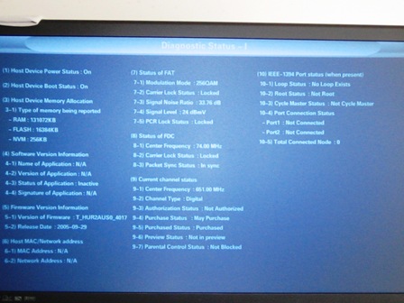

Ok, I've made a little progress (hopefully). After calling TWC and Samsung a couple times today and running down their best ideas of how to fix, I finally got someone at Samsung who told me how to get into a Cablecard Diagnostic menu. (fyi, press MUTE, then 1, 8, 4, EXIT)
The screen was filled with all kinds of diagnostic information, some of which corresponds to a lot of stuff I've seen here. Anyway, from what I can gather, here are the bits of info that seem to be most pertinent to this discussion....can you please interpret what you see?
(7)STATUS OF FAT
7-1) Modulation Mode: 256QAM
7-2) Carrier Lock Status: Locked
7-3) Signal Noise Ratio: [Ranged from 33-35ish]dB
7-4) Signal Level: 24dBmV
7-5) PCR Lock Status: Locked
(8)STATUS OF FDC
8-1) Center Frequency: 75.25MHz
8-2) Carrier Lock Status: Locked
8-3) Packet Sync Status: In Sync
(9)CURRENT CHANNEL STATUS
9-1) Center Frequency: 633.00MHz
9-2) Channel Type: Digital
9-3) Authorization Status: Authorized (*says NOT Authorized on the "new" channels I'm trying to get however)
9-4) Purchase Status: May Purchase
9-5) Purchased Status: Purchased
9-6) Preview Status: Not in Preview
9-7) Parental Control Status: Not Blocked
So anything you see here that didn't seem clear before....or any other info I could post that could help? I'm calling Samsung back tomorrow to discuss this more, because the tech that got me to this screen didn't tell me at the time I needed to be on a Digital channel to get the right numbers for Signal and SNRatio (told him they were zero and he freaked out and told me to call TWC back right then.)

Kitch, the only thing that stands out like a sore thumb is the signal level 7-4) Signal level: 24dBmV , that level seems about 15 - 20 dB too high, if you have a signal amplifier in the house that is feeding that line, get that line off the amplifier, ask them to hit the card a few times and see if that corrects the problem. Something else you should do is send that data to Samsung and let them interpret what it's telling you.

cableguy.....
I called Samsung back and told them the levels on Signal Level and SNR...to which he told me both were too LOW.
So I called TWC and spoke to a tier 3 tech who says that the SNR (range of 33-35) is about right, and that the Signal (24dBmV) is a little LOW, and they will send out a tech saturday to test the line and possibly install an amplifier. Also explained that the SNR SHOULD be low, as the higher this number is, the crappier the picture would be (makes sense to me).
Now...what's going on? How can you and the 2 other guys all be saying different things? Am I screwing up by giving the wrong information or something?

24dBmV is too low???!!!!!! The operating specifications on the CC are +15 to -15 dBmV, how on earth can +24 be too low? LMAO, sorry but something isn't adding up. Do me a favor, when the technician gets there have him check low pilot or high pilot and the foward data carrier and get those levels posted here so I can see them. If +24 is too low, and we are talking about a physical channel signal level, then I'm the Rasputin :-)

I agree with cableguy, your signal is way to high. I have TWC and mine typically is -6 to +6. Your SNR is a little high but that is because of your high signal. You should be getting a picture on that signal though. Check your cablecard diag screens in the samsung menus to see if you are getting the ECM counts going up. If no ECM counts then TW is not sending you the permission to unscramble the signal. Pop the cable card out to see if you can get your non scrambled digital channels. If you can get them without the card, it is a TW issue (they are not sending the ECM codes).

Have to agree with Cableguy. If 24 is too low we will also have to change all those diag screens on the STBs that tell you 24 is out of range, High. Ours normally go yellow above 10. In previous post Kitch said the Tech brought in an STB, and it worked. If there truly was 24db there, I seriously doubt it would have, and I can't imagine a service Tech missing 24 db on his meter. Something is flakey with the levels the TV is reporting. Something also seems flakey at Tier 3 as we will have to unlearn everything we have been taught about S/N if we start doing it their way. My STB is giving me 38db S/N readings on HD channels with 6db signal in, and there is nothing crappy about the pics.

Most of the time the SNR on your STB should read around 30-36, usually they hang around 34 if everything is working properly. I've seen problems on the CC when the SNR drops below 28, never seen one higher then 36 so don't know what that would do to the pictures. Bottom line is something is definately out of whack there and for the record 24dB on any channel frequency is higher then specifications allow for signal to be coming out of the tap. Generally speaking the signal levels out of the tap are not higher then +19dB on the high band, 24dB would be an immediate flag.

Guys-
All good info, I will try to get to the bottom and post the findings (and hopefully a solution soon) here.
If you are saying there is something wrong with the 24dbmv reading, would you think that's a problem with the tv or the cable or what?
Just trying to get facts straight before the tech shows up tomorrow morning.
Weird thing is that both the Samsung guy AND TWC guy told me that the number was too low....

Well if that's the SNR levels it would be too low, but if it's an actual channel level then it's too high. Sorry for the confusion, as I said I've never seen that particular diagnostic screen.

Wacko3Anime
Unregistered guest
hey guys after hours of searching will waiting for sony and cablevision long island to call me back, i found ya here, could use some help, picked myself up a sony kdsr50xbr1 manufacture date stamped on the back of october2005. No matter what we try ( I use the royal 'we' because i am having to act as a go-between for sony and cablevision on this issue), different CableCARDS, different resets, and different everything. I can not get the CARD to marry to the tv....I get an error message like this(50)Invalid Host Certificate [which is also viewable under the applications heading for the cableCARD, under host/cc binding:] for CableCARD ID: lists a bunch of numbers (**which cablevision says doesn't match or jive with anything they have) , and then under that says ---and Host ID: Unknown...call an 888service # for cablevision. Calling that results in nothing but them telling me that the card is not activated, we have tried 8 different cards and 3 different sleeves for the card.
Sony had a servicer come out and all he did was pop the card in, take the card out, tell me it was a compatibility issue and to let him research the problem. That was today, the first servicer i contacted last week just told me straight out he had no clue what i was talking about, and then didn't even want to meet up with the cablevision techs when i had them here on monday trying cards 7, 8,....which are NDS cards, the hd stb they left behind is scientific atlanta, and i hate it. Even without the Host ID i am able to get all the channels that don't require de-scrambling. After a month of dealing with this i finally demanded sony make good and stop blaming the cable company and the card and tell me whats wrong or at least send someone more knowledge, or willing to do more than just tell me it won't work. They got a tech guy on the line who just tried to overwhelm with the aspects of this problem that are cable company related. Let me know what other information I can provide, I took photos with my camera of all the menus after attempts that changed data.
I mean sometimes under the DEBUG PAGE i get this:
Pod Manufacturer:02-00***
Start Module: 06/01/1980***12:00:14
Reset Module(31)***SmartCard(0)***
TDA Config:0x31 --SCard Detect: 0***
CIS Startup executed***
SCard Detect:1***
Reset Status: SmartCard(1)***
and on another install attempt i got
Start Module 30/11/2005 *** 01:28:05***
Reset Status: Module(15)*** SmartCard(2)***
TDA Config:0x31 --SCard Detect:1***
html> (this is actually exactly what was displayed)
Each side played me back and forth long enough to prevent me from just returning the tv to the store and trying a new one, so any help / advice would be appreciated.

We did have some problems that were resolved by a software update from Samsung, keep on them and see if they are willing to send an actual Samsung repair rep out to your home to look into your problem (actual repair tech doesn't mean a factory authorized service tech, it means exactly what it says).
Wacko3,
For a Sony the host ID should be a 0-070-XXX-XXX-XXX number, is that correct? As I've never encountered an error message of " (50)Invalid Host Certificate ", I don't know how much use I can be in helping. It would seem to me, on the surface, that there is a communication issue between the CC and the Host, and rather then get in the middle of who is at fault, it would be easier to demand your cable provider get in touch with Sony and coordinate a repair visit to your home to figure out what is going wrong, I can tell you that SA cards in my division along with Sony TV's always work on install (unless there is a hardware conflict with a cetain model) Usually with the Sony's there is a error that can occur after the CC is up and operational that will cause channel to stop working, which can be corrected by using the reset feature in the TV menu. The long term fix is for Sony to come out and replace the CC interface. I wish I could be of more help, but all I can offer is advice, stick with it and settle for nothing less then joint coorperation between the two companies involved; your provider and Sony.
Please keep us posted
regards,

Okay, spent most of the day talking to Sony, after about 7 calls and 6 hours, they finally agreed with cablevision and me, it's not the cards, it's the reader. They are ordering me a a new reader [q-module(?)], I think. Monday should be the day for the install, and then we'll see. After reviewing most of the posts here, I'm not expecting to run into any cable co problems that are completely unknown, I already have my fingers crossed. I don't know what the host id number is either yet, as none of the cards have been able to get the tv to produce one.

That is exactly what I described in my recommendation, the CC interface or Q-box needs to be swapped out. Good luck with it, and please keep us posted.

Greetings. Thought I would post a pre-cursor to this afternoons appointment I have with my WOW tech. Attempt number 2 at getting myself a CC installed. My wife was home for the first attempt and apparently the rookie sent out to do the install had no clue what he was doing. I have a samsung hlr-4266w and WOW uses SA cards for my area. The first attempt resulted in no picture channels, music channels worked on audio only, and as such the tech took the card and left me with nothing. Policy states they can't leave the card if its not working. Frustrating since I can't attempt to get it to work myself with Samsung's assistance if they won't leave the card. I have gathered a wealth of info and will update this afterwards.
Username: Lothos
Westland, Mi
So, finally after 2 hours of effort I manage to have a functional HD cablecard. The tech and I tried everything we could think of and nothing was working. No picture on any digital channel would come up, but the digital music channels worked. The host name was not populating which is a requirement check for functionality. Finally, we manually set the time on the TV and it got a host address and began to slowly come to life as it populated.Upload

Username: Lothos
Westland, Mi
What's wierd is all the HD channels come in fine save for one. TNTHD which comes in audio only with black video. No idea why just one channel.
My Samsung has a nice glare screen that makes pictures fuzzy a bit. Here's a full size pic:
http://www.lothos.com/diag.jpg
Username: Bugspk
River Edge, NJ
Registered: Dec-05
Mike,
I can see that your CableCARD has not completed the validation. 9-3 on your picture shows that the channel (651 Mhz) is not authorized to be shown. You should check your SA CP screen as well, Authorization status as well as ECM and EMM count.
Username: Lothos
Westland, Mi
Actually, that was before we got it working. So it makes sense. I forget what channel we had it on. 485 I think.
These are on TNTHD channel 209:
http://www.lothos.com/diag2.jpg
http://www.lothos.com/diag3.jpg
It's dark today so the pics are a bit dull.
Username: Ifeengineer
Mike,
I have a Samsung HL-R5067W. I have had 3 cable cards and 2 different TVs (each TV saw 2 cable cards). They all have good audio for ESPN HD (channel 202) and a blank video screen.
I different thread in this forum said to check with the cable company to see if the PID was correct (mute-1-8-5-exit). Bugspk also suggested checking the "CableCARD] - [CP screen] - [CCI Byte. If is it not zero (0X00), then this channel is in copy protection."
Username: Cableguy
Deep in the ...
U.S.
Post Number: 689
Registered: Mar-05
that CCI byte count has nothing to do with the video not coming in. Your TV is HDCP compliant so it's a non-issue. I'd wager it's something with the PID or a frequency issue before I'd blame the copy protection flag.
Username: Bugspk
River Edge, NJ
Registered: Dec-05
Mike,
Since the audio is comming, TV tunes at proper freqency. Head End may send only audio but not video. Please make sure with your Cable Company and verify with other people in your local area who is using CablCARD.

Cableguy - I would really appreciate your help with my cablecard problem. I have one of the first cc installs in this area on verizon fios. the techs have been here twice for a total of 6 hours and it still does not work. the tv is a philips 32 lcd and i can get analog and some digital channels (tv has a qam tuner) with only the coax connected. the tv immediately recognizes the cc when it is installed and the cc remaps the channel numbers to the correct number (i.e from 813.62 to 145) and displays the correct channel header information. However, with the cc installed I only get the analog stations and a few HD stations (some without sound). the signal strength is -7.4 and +4.6. according to verizon, the tv sees the cc, the cc is working correctly (they replaced it after the first visit) and the signal is good. the noc tech says he can see the cc on the system.
the tv has 5 screens that show cc info: here is what they say:
cc pairing screen:
cablecard 000-298-975-044-9
host 015-002-118-127-9
data 214-187-246-68
unit address: 000-02989-75044-116
network setup screen:
LKC 75:250 [][][] EMM:1
status: tuned state
OOB messages: 12823
cc status screen:
manufacturer 0x00 (motorola)
version 04.21
unit address: 0011D1FF44
000-02989-75044-116
download status
wait to start
entitlement management messages
EMM provider ID:1
conditional access screen:
unit address:0011D1FF44
000-02989-75044-116
encryption: conforming CSA
connected: No, enabled by CP: Yes
auth: subscribed
ca enable: not possible
ecm pid: 0x14B4
component PIDs
0x00D2 0x00C8 0x0000
0x000 0x000 0x0000
host validation: unknown 00
copy protection key: disabled
interactive info screen
ip address: 0.0.0.0
upm address 0
downstream id: 0
upstream id: 0
downstream: unconfigured
upstream: no mesages to send
ack time out: 0
cell abort count: 0
MAC abort count: 0
the NOC tech says they have escalated the trouble ticket to a supervisor and is sending a tech on site again tomorrow. i greatly appreciate your thoughts on what they are missing.

I don't know much about the motorola screens, as we are an SA site. What I can offer, based on your channels you can't get, is that it sounds like the card was not provisioned properly. If you pay attention to the last line under the "Conditional Access" section: copy protection key: disabled disabled should read
enabled. Since it doesn't I can only assume this means it wasn't provisioned properly. (notice I said I don't know much about the motorola screens, I didn't say I don't anything about them)
If they can figure out what they need to do to get the copy protection key enabled, you will find the solution to your problem. I hope that helps, and please keep us all posted.

Thank you cableguy and I think you are correct. I found a 13 page motorola technical service document on the internet and it helped me understand the activation process. The fact that ca enable is not possible, host validation is unknown and copy protection key is disabled lead me to beleive that the cc has not received a "good" copy protetion validation messge. I think this is likely due to the card being on the certificate revocation list (which is maintained not by Verizon but by CableLabs). My theory is that techs are trying 2 or 3 "new" cc when they can't get the first cc to install properly. Each time they try another one the previous cc gets put on the certificate revocation list and no one at Verizon is getting them removed at CableLabs. The cards are recycled in the system and the techs show up to do an install armed with a cc that cannot be activated. JMHO. Anyway, Verizon had a tech on site for 3 hours yesterday with no luck. He is to come back tomorrow with a "new" cc. Hope my theory is wrong or that it truly is new.
Username: Dorsey
Dover, FL
Registered: Apr-06
Cableguy - The cc is fixed after 4 tech visits of 16 hours total. that does not count the multi-party conference calls verizon engineers had with my tech while on site. turns out that cc #1 was indeed bad. cc #2 installed on the second visit had never been entered in the Verizon equipment database and so could not be activated. Unfortunately, the techs and headend people don't know that the card is not in the system and get no warning message. After being escalated 4 levels, some engineer in Dallas finally figured it out when he tried to send a reactivation signal. They put cc #3 and it functioned properly. Verizon is still in a learning mode on cc but I will tell you this - no other cable company would have devoted the time and effort they did for a $2.95 a month cable card. I was never told that the TV was at fault or pressured into switching to a STB. The tech told me on visit 3 that he would take ownership of the problem and get it fixed and he did. I am highly impressed by the Verizon customer service and the picture quality of the cc is great.

Don't know if you can help, but I'm on Comcast with a Mot CC on version 4.05. Everything is generally fine, except that every 3-5 weeks, my TV's digital tuner corrupts and many (but not all) channels come in corrupted (not just blocking, but errors in the blocks and the picture is jumbled). Some channels, like the encrypted INHD2 are real bad, while other channels that are digital SD (i.e. CNN) are corrupt but not as bad. The only way to correct the issue is to unplug the TV (power reboot).
I've been troubleshooting and talking to Toshiba (TV is a 62MX195) and have the latest F/W 1.3.1, but they claim they're not aware of any similar issues. This problem appears like clockwork ever 3-5 weeks, and then always happens twice within 2-3 days, then is fine again for another 3-5 weeks. My theory is that Comcast may be sending something downstream to the CableCard that interacts with the tuner and causes the tuner to corrupt. Would this make sense?
Thanks,
John
Username: Magredc5
Southern New Hampshire
I've also discovered a pattern in the channels that become corrupt when my problem occurs. The channels that have "copy protection key: enabled" are the ones that exhibit the problem, but those with "copy protection key: disabled" are generally OK during the problem. Could anyone shed some light on whether this relationship between this field and my corruption problems is something worth looking deeper?

Your cable provider has done a thorough inspection of the cabling at your home, assureing you have proper RF (proper being clean and strength) at the back of your tv? Sounds alot like an ingress problem to me, but I could be wrong.

ingress or the QAM is breaking up, it wouldn't hurt to see if somebody can hit it with a spectrum analyzer to see what is physically going on with the QAM signal. The strange thing is every 3-5 weeks, makes me wonder what is happening in that time period that causes the problems and what isn't happening in between?? hmm.....
Username: Magredc5
Comcast has been out and tested the signal - it was apparently well above minimal levels (I believe it was -7 dBm). If it were a signal issue I would expect it to come and go more frequently, and not be cleared with a power reset of the TV.
I'm planning to put another call into Comcast to see if they can shed some light. The more I read about the CC specs and interaction, I suspect the CC is triggering some type of update (i.e. some type of channel protection key authentication update?) that somehow doesn't completely mesh resulting in the corruption. The fact that it's happened enough times now over the past 6 months, and that it happens like clockwork every 3-5 weeks and in pairs, to me indicates some type of scheduled process that kicks in and never gets completed. I would expect if I give Comcast specific dates and times, they could investigate their end for logs or scheduled activities. This last occurence on Saturday happened while I was watching the TV where everything (all channels) was fine then suddenly it happened.
Is there anything I could compare in my CC diag screens before the problem and then during to further pinpoint a conflict?

-7 on what frequency? If that's a low end level, then you most definitely have a signal issue. If it's the upper end than its marginal.

I checked my notes since this was back in December when Comcast came in and checked the signal entering the TV. He measured 5-7 dB above the acceptable levels (not -7dBm) and indicated the signal was very good. I am positive I do not have a signal issue for the following reasons:
- My TV has TVGOS and the diagnostics screens provide info on packet errors. I have less than 0.5% errors on the key C packets which are transmitted over an analog VBI channel.
- My TV also has a signal meter built in that indicates 95-100% signal level on all channels.
- The problem is not random or sporadic as one would expect if the problem was a poor RF condition.
- When the problem occurs it only affects channels with channel protection enabled.
- A power cycle of the TV clears the issue.
Every points to a s/w issue in the video processing. The question is who is corrupting the processing and why is it unrecoverable without a power reset.
