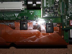

hello friends,
Does anyone have access to the partslist of the X-SUSTAIN board of a Plasma Panel Daewoo Dsp-4210GM with SP-110 chassis?
I found a shortcircuited Mosfet SSH25N40A (QU4) , also in the Gate of this Fet i found a burnt SMD Resistor RCU20.
Does anybody know the value of this resistor, please? It is totally unreadable.
Thanks for any input!

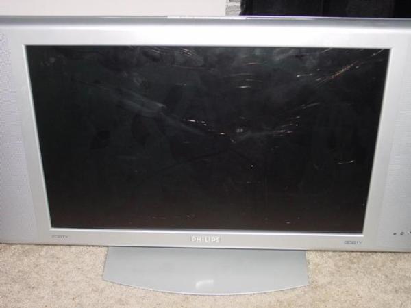

I have this Philips 23" plasma hd/tv monitor and as you can tell it has been kicked. The first pic is the screen when its on. It works fine, just the screen is trashed. Is there any one who knows if this screen can be replaced? I'm thinking it can't. Any ideas what the cost will be to fix it or how much I can get for it as-is? If you know a place on the WEB I can sell stuff like this it would sure help me out. Thanks

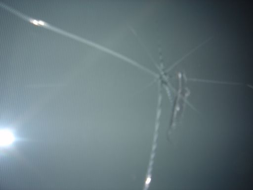

Hey,
I bought a Phillips High Def plasma tv about a month or so ago. It has a small crack at the bottom of the scree, which can't be seen in the picture. What would be the cheapest process to fix this? And can it be fixed. The model no. is 42FD9954/69C. I am worried it will cost me close to what I paid for it to fix this. It cost me $5000.
Any help is appreciated
cheers

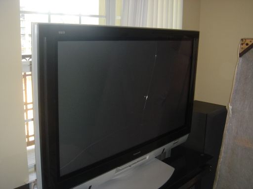

I have a broken 50" Panasonic plasma tv model #TH-50PX25. It's about 2 years old. I moved from San Diego to Atlanta and the damn movers broke it even though they thought it would be fine. Well I heard about the crazy costs of around $1800 but due to time constraints I had to buy a new one. Basically I'm trying to offload the broken plasma tv. The plasma is cracked, not the glass protecting it. When you turn it on a high pitched buzzing and no picture is what you get.
Let me know if you're interested. anthony.leadbetter@gmail.comUpload

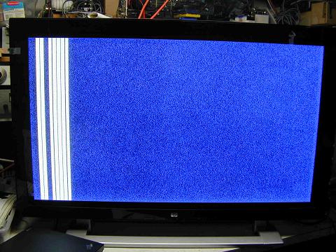

Help! My son threw a pillow at our plasma screen and although the glass isnt broken, it doesnt show any picture but a load of red and blue lights where it was hit. Can this be fixed?

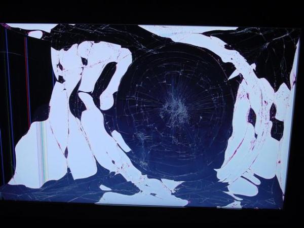

I have a Prima 42" Plasma (PS-42T8) that someone broke while trying to steal it from my office, and as it's trashed I'd like to turn it into a coffee table! The front glass is intact, but all the guts are broken.
What do I need to know about the electrical components inside, so that I don't shock myself during disassembly?
thanks for any help you can give,
Ben.

Advice Needed Please!!
I have a Philips 42FD9932 that is about 3 years old. It did the loud pop, red blinking light thing a few months ago, but after powering down a few hours, it came back to work another 3 months with no trouble. Popped again last week, and is no longer working. Heard about the Power Supply board issue and was ready to buy one, but a local tech offered to open it up with me and check the boards for $50.00. Appears the P/S board is ok, but 2 of the "chips" on what he calls the "scan board" have what appear to be small burn holes on them. This board has a ribbon cable that seems to be permanently attached to the screen, and I was told that the board in these older models is non replaceable, and the chips are not removeable either, and that essentially the TV is now a boat anchor.
Can anyone concur?
Thanks!
Username: Drvee12
Registered: Apr-07
Here is a pic of my "Scan" Board with burn holes in the chips:
Username: Zidek666
Apple Valley, Minnesota
Registered: Apr-07
I don't concur.
Those holes may be normal as I don't see any discoloration around them.
If you heard a loud pop, it's highly likely that a MOSFET Power transistor blew on the PS board. IC's rarely go "pop" when they malfunction. Have the tech re-examine the PS board and visually check all the transistor with heat sinks to determine if any are discolored or ruptured. Use a magnifying glass and a flashlight and visually check every component that has a heat sink for physical damage and discoloration.
If you find one get a tech that knows how to replace it and has a schematic diagram or simply get a new PS board. Also check any fuses on the PS board.

Username: Ofriel
Registered: Jul-07
Hi, I bought a new 42'' panasonic plasma and it came with a long crack across the display panel, and another piece is broken.
My wife didnt check the content when she signed the delivery (I was on a business trip) which would have saved us the whole frustration cause she could refused the delivery.
Im going to contact the company tomorrow - has anyone faced this situation?
On their site they mention that they have no liability if customer accepted and signed the delivery?
The plasma is still in the box as we got it.
any ideas? please advise!!!

I have an HP PE4240N with P42V6 board set (LG?)
It has good audio but bad video after a power outage. Vertical colored stripes with varying color per in the stripe per picture. Channel display makes white strips. Some guys say YSUS board and 2 driver boards bad, another guy says CTL board and 2 associated boards. Need to undertand what board does what and which is bad. Too expensive to experiment with buying wrong boards.

I took mine to Ali at Discount-Merchant.com (see earlier post in this thread). I blasted the internet for advice on fixing my plasma and got totally differing suggestions. So taking it to him was the only sure bet. Luckily it seems two Y driver boards were bad - the cheapest boards and he had them in stock. There are also some voltage adjustments suggested after boards are swapped and you likely will not have the equipment to do them.
Username: Bklein
Trabuco Canyon, CA
US
Oh, also, given the problem you cite, it sounds like what is called a chip on flex. The chip is on the flex circuit that goes to the plasma tube directly. I am not sure how they fix that. Do a Google search for PDP42V6.pdf and download it - look at page 13. (too big to attach here)
Barry

For all of you with Broken plasmas or LCDs I feel for you. My daughter broke my new 47" lcd right before christmas.. basically an 1800 dollar loss. My suggestion.. pick up a screen protector from http://www.tv-armor.com It stops people from cracking the screen accidently. Now I dont worry about her playing near the TV.
