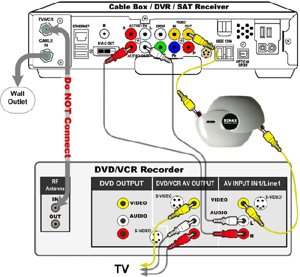

Debra B - I've done this myself. Here are two options.
1. If you have a MiniDV or Digital8 video camera, simply run the RCA outs from the TiVO to the camera's RCA "in", then connect the camera via fire-wire to the PC and capture using any number of products (Sonic's MyDVD, ULead Studio etc.)
2. The Adeptec VideOH! converters. You can find this equipment at any CompUSA, Best Buy etc. This small unit wlll convert any analog source to digital output. (and can take the S-Video, too) and connect via USB2.0 to the PC.
You can capture as AVI or Mpeg2 - or DV format. Depending on software, you can burn directly to DVD. I've done both - both work fine. Just keep in mind, if you take two hours of AVI, it is about 25 gig of data... take the same as MPEG2 and it is about 7 gig.
Most recently, for less than $140.00 I bought a DVD burner, connected it to component out and have burned 25 or so DVDs - everything from broad cast TV to movies.

what is so hard? you dont need to be concerned with the "record to VCR" function. all you need to do is playback whatever you wan tto record and then hit record on your dvd recorder and sit through it in real time. Boom, there's your copy. Composite or S-video out from DVR to Composite or S-Video In to the recorder. you're set.
Anonymous
"""Composite or S-video out from DVR to Composite or S-Video In to the recorder. you're set."""
It actually wasn't QUITE that simple - when I have an HDTV, DVDR, DVR, VCR, CD and RCVR all hooked up together. I guess its a matter of trial and error, what to plug into where to get it to work. Thank goodness for +RW DVDs to try and try again. But otherwise, once connected, yeah just it record for whatever your watching, or play whatever is on your DVR then hit record on your DVDR. Just wish I didn't have so many wires connected. The problem I had was keeping my VCR connected as well to my DVDR, so I didn't have to keep switching wires when I wanted to record from VCR to DVDR or DVR to DVDR.

Philips DVDR-75 has no component input, it is component output and it will not help you. I also do not think your TV will provide component output. Shortly you have to use Grex Video Stabilizer : http://www.xdimax.com/grex/grex.html connected this way:
http://www.xdimax.com/grex_faq/faq_howto.html#stbdvd

When you were recording did you see video?
Have you connected it according to the diagram I've showed?
Username: Broncogene
Registered: Oct-09
Ella - Yes I did see the show I was trying to copy (Video) on the TV. And it appeared to be copying on the DVD recorder. No I don't have the DIMAX - If you think I need this Device to get the picture on the recorder I will purchase one.
Gene M.
Username: Ella
Post Number: 21
Registered: Apr-06
Hi,
You will need Dimax Grex later after you fix your connection.
Make sure you connect everything serially:
DVR--> DVD Recorder --> TV
andTV is connected only to DVD Recorder. This way you can check if video is passing by DVD Recorder.
