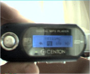

Take a digital image of the unit and post it here.
Someone should be able to help ID your unit

hello,
my mp3 player's chipset is sony
and in the driver cd of mp3 player name of the firmware file is JYT001 V2.0_RV7CHL (version 1.42) I needed latest version which i have updated with older version which was 1.43

Username: Smilegirl2828
Registered: Apr-06
Hi,somebody can help with this ? Upload
First I have update with wrong firmware after I can find the full firmware and dump files, when I dump the files its look like the picture...thanks

Hello smile,
do you know if your Centon unit is a sigmatel unit?
Registered: Apr-06
really? I dont know... o_O
Registered: Apr-06
I dont think so my player is sigmatel because my chip is ATJ2051 and sigmatel is ATJ2075/3 or something...

smile ,
I was only able to find 1 file for this make...
Is your centon unit 256meg with FM tuner ?
Only if yes,
Registered: Apr-06
the firmware nop work, I have tried update with the centon page, I have to get full and dump files with s1mp3.org, but nothing change like the pic... My player is 256 FM... thanks, sorry my english is very bad I'm from Venezuela
