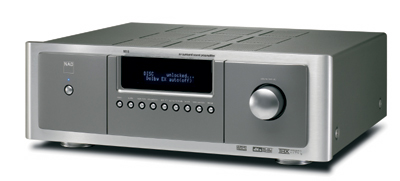

CEDIA 2005, Indianapolis, IN., Sept. 9, 2005 — NAD, the highly regarded manufacturer of high-performance audio components, introduces the M15 Surround Sound Processor, one of the first four new components in the new Masters Series during the CEDIA Expo 2005 in Indianapolis this week.
The M15 is THX Ultra II Certified and features HDMI switching, dual differential 24-bit, 192 kHz DACs, Dynamic Headroom Scaling for optimum digital resolution and a linear power supply. It offers the widest array of surround formats including Dolby Digital EX, DTS ES Discrete and Matix, DTS NEO:6, THX Ultra II post-processing, along with 7.1 Matrix, Dolby ProLogic II and the proprietary NAD EARS circuitry for creating natural surround sound from any format input, 7.1, 6.1, 5.1 and 2.0 stereo, digital or analog.
