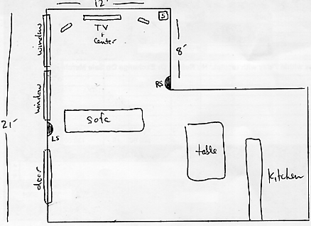

Hi, I've just purchased a new home theatre system (5.1). I will be setting it up in a room which is 12' by 21'. However, the sofa will only be about half the length of the room (10 or 11') away from the TV. My surrounds are Mirage FRX "omnipolar" Surrounds. I am planning to place the Left one about 6 feet high and level with the sofa; however, due to windows, the Right one must be placed about 3' in FRONT of my sofa (same height). Will this cause a big problem? (for two reasons, one being that the speaker will be in front of me, the other being unequal distances from each). Moving the couch further back is not an option.

Only other thing I could do is put the surrounds way back on the wall behind the couch (10feet), or I could move the couch even closer to the TV so the the R speaker would not be so far in front of the listener. (LS=Left surround, RS=Right Surround, S=sub)

From your diagram, I would personally choose to put the surrounds right back behind you, the same distance for left and right, maybe near the back wall. You should, anyway, adjust the delays (1 foot less in distance to be compensated by one millisecond extra of delay) as well as the levels (in dB, so each channel sounds equally loud with the test tones, heard from the sofa). The thing to do is buy enough cable for the twice the longest run you will need (cables for two matched speakers should be equal length), then fold up/hide away any surplus length, but keeping the real lengths of cable the same. I wonder where the amp/receiver is in that plan? We have an awkward, L-shaped listeneing room, too. You could even put the sub against the back wall, too. Sub sound is not directional; it should just fill up the volume of air in the room, and that would include the kitchen/dining area, too.

Well, for those of you still following this thread. I set up my whole system today (well yesterday and today, to be honest);see my profile for system components. I set it up exactly the way I have it in the picture, with the L surround beside the listener and the R surround about 3-4 feet in front, and, after adjusting the levels and delays, it sounds awesome!! And, probably more importantly is that my wife approves of the aesthetics.
