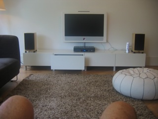

Username: Josephine
Post Number: 8
Registered: Feb-08
Nuck,
They now stand on a kind of silicon units. I will attach a picture of the situation.
JUpload

You've set them on top of what will be a resonant box once they start playing music?

If the side and back walls look like the front wall then it is certainly feasible the "hardening" you mentioned is room related. Vast expanses of gyproc and hardwoord floors (although I see you have an area rug) can create some accoustical nasties. And, as JV points out, you probably have about the worst possible base for the speakers in that cabinet.
First question....how much are you willing to fiddle with speaker placement and potentially room changes/treatments ?
Username: Nuck
Post Number: 13166
Registered: Dec-04
Stands first, so as to be able to get the Dyn's away from the rear wall, and 3' out into the room.
Then placement, placement.
As Jan alluded to, the speakers on that big resonant unit will never expose the best parts of your system.
And the Solo would be better supported with some help, too, but speakers very first.

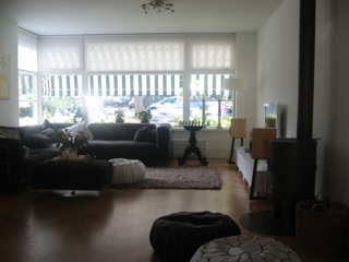

Beautiful room Josephine.

Hi Josephine,
I'm inclined to think that the Solo Movie 2.1 is not really a good enough source for the speakers. It should work reasonably well, but the speakers are capable of a lot more than the unit is capable of giving them, and this doesn't just relate to power rating. It's everything from the quality of the CD section through to the power amps.
That said, it appears you haven't optimized what you have to the best of its ability. I think you could do far better with correct positioning etc. The photo shows a lovely room (great aesthetic) but the speakers are in a completely inappropriate location for the following reasons:
* They're way too low - the speakers should be at head height when you're seated.
* They're far too close to the rear wall. This will cause a flattening of perspective, over-emphasis of bass and a hardening of vocals, particularly when the volume is turned up (since this excites the wall behind it).
* The 140s are capable of significant bass - that unit will resonate, even with the vibrapods underneath them.
To fix this, you need stands, not too light (but not particularly heavy). The speakers could be placed on the stands on either side of the unit with their rears about 45cm from the wall. That will help things enormously. If you can't have them so far from the wall, you can try using the foam bungs they come with, but my experience is that the foam bungs really compromise sound quality by pinching the midrange (vocals particularly) which can also harden the sound. My only concern with this advice is the couch on the left hand side being in the way of the speaker on the left when you do this.
As for using a more powerful amplifier, yes this is possible, but I'm just not sure it's appropriate. What you really want are speakers designed to work against a rear wall which are quite difficult to find. Spendor SA-1 or Naim n-SATs come to mind, but they're both very different to the 140s.
Finally, does the Arcam get hot? If it does, this is a sure sign that the 140s are making it work hard. That will not help matters and would be the only situation where I'd suggest another power amplifier, but my comments above still stand (pun unintended but appropriate...).
Hope this helps,
Frank.

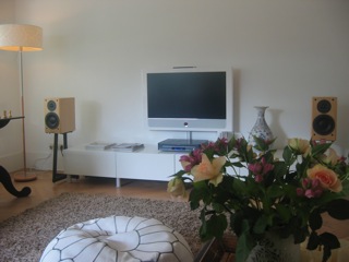

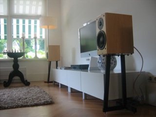

Username: Josephine
Post Number: 10
Registered: Feb-08
Guys,
I have taken some first steps. Take a look.Upload
Username: Soundgame
Toronto, Ontario
Post Number: 915
Registered: Jun-08
J,
That looks great - how does it sound now, just with the stands added?
You'll now need to experiment with pulling the speakers a little more into the room / forward. You can also experiment with toe-in - pointing the speakers a little inward toward your main listening position. Start with just a tad little bit - about 5 to 10% and listen to hear if there are any benefits.
How high are those stands? What type/brand are they?
Username: Josephine
Post Number: 11
Registered: Feb-08
George, the difference is so big that I am a bit ashamed that I put them on the cabinet in the first place.
I found them on the internet, second hand, 50 euros. The brand is standesign. (They have sharp spikes, so I need to find some protection for the floor).
But the important thing is, music is present, detailed, nice. Very nice. How much inward would be ideal? I will experiment further.
What Frank might notice is that we have changed the couch, made more space on the left. Not 100% ideal yet, should be an open low-end sofa on that side, but hey, we are getting there.

Excellent Josephine. Small things can make big differences. That's a wonderful living space.
Do you have less hardness in the music now when you turn the volume up ? Less/more bass ?

Jo, we weren't just kidding you, eh?
The stands are funky and your living space looks very Euro-nice.
You might be surprised by little changes in the speaker placement/toe-in. It is a personal thing, but if you have your roomie make slight moves in toe, while you sit in the best spot, you will likely find a placement that makes you very very happy, and maybe a bit surprised.

Looks good! I think you'll find that the upward facing spikes can be removed. There are two ways to support speakers, either by decoupling them from the stand (upward facing spikes) or by coupling them to the stand (remove the upward facing spikes and stick the speaker to the stand using blutac). Personally i usually get better results with blutac (and it doesn't put holes in the speaker), but you never know!
You can put coins on the floor to save it from the spikes. Alternatively there are floor protectors available from most hifi dealers. The ones we sell are made by a company called PureSound. They come in sets of 6 and 8. I'm sure you can also find floor protectors on the 'net.
As for toe-in, well, just play around a bit. If you're happy with what you have then don't worry too much, but a bit of playing around will pay dividends.
