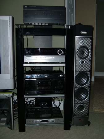

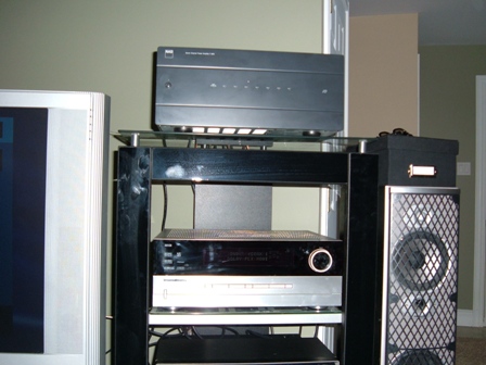

Username: Praetorian
Post Number: 472
Registered: Dec-05
Can hardly see it - I will try to post a pic...
Username: Nuck
Post Number: 13393
Registered: Dec-04
I , personally, have no issue with the exposed functional conductor look, but 4 out of 5 wives disagree.
Post Number: 473
Registered: Dec-05
As you can see by the morass of wires behind it, it is the least obtrusive in the set up...
Post Number: 474
Registered: Dec-05
Ugh - need to clean fingerprints...
