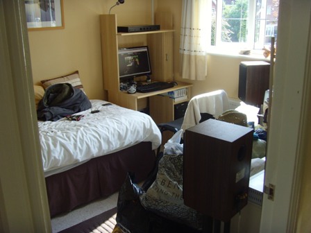

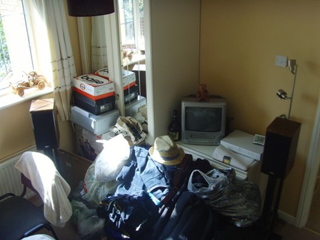

Chris, heres the pictures..my room is a mess because I haven't unpacked properly yet, just handled the important stuff!
The amplifier is on top of the desk. Using Chord Din Interconnect and Classic Cables ( I love Chord).
I've just notched the bass up to half 1 on the amp and this seems to have done the trick to some extent. I honestly think I need a small sub which I can put underneath my desk.
Dave, I have done and before I had them completely parallel to the walls, as they are in the pictures seems to work better. As you can see, I have very little room to work with. Interestingly enough, my room at university was about twice the size!

Thanks for the pics JJ. With the room furnished the way it is, it'll be difficult to get optimal speaker placement, that's for sure.
The left speaker is really close to the wall. Have you tried moving it out a bit?

I haven't tried that, its just in all honesty it has to be like that or I wont be able to move around.

The room looks well dampened....

The left speaker port displacement is bouncing off the wall and against a mirror.

The doorway isnt doing him any favor either,I would try another way with no doorway or closet opening like where your bed is.Like Art said the room looks well dampened,and it doesent look to big for the Neo's to perform optimumly without a sub,just play around with different walls,you should be fine,or either your just ready to get new speakers.lol

I'm glad it passes the dampening test. I really wish I could have had the desk against the larger wall with speakers either side, but I couldnt convince the parents when we were decorating the room a few years back.
I suspected the doorway and mirror would be a culprit. My room is generally a poor setup then! New speakers I can only imagine would cost considerably more than what I can afford!
I'll live with the bass turned up a bit for now, I'm surprised how more balanced it sounds by just doing this.
I may try covering part of the miror!

The room may be too well damped. I'm guessing that you have some very good (and accidental) bass traps....the box spring, mattress, and comforter especially. If sound balance is the issue, then you need to have less in the room that absorbs the frequency of sound that you're missing....in this case bass.
The lack of one frequency range can make the another frequency range seem overstated, when perhaps it isn't. You probably don't want to do this but if you could, try largely emptying the room, orient the speakers in some reasonable method, and then slowly add things back in and see what happens as you do. You may not be able to leave things that way, but you'll at least know how much of the issue is room, and how much is gear.
I think you'd get great sound out of your gear if you can get the room right.
