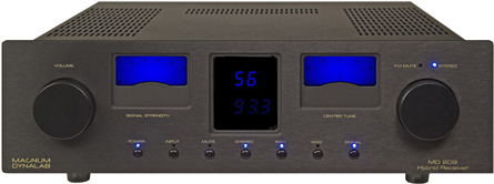

Username: Stu_pitt
Irvington, New York
Post Number: 3269
Registered: May-05
I'm not a fan of receivers, but this one will probably make a bunch of us put our foot in our mouths...
This is the entry level one. Tube/Hybrid, tuner, DAC, and 125/250 wpc in 8/4 Ohms. Made in Canada. Magnum Dynalab doesn't make junk. Only $5800. Who'll be the first one to try it out? I think Nuck's got some cash burning a hole in his pocket.
http://www.magnumdynalab.com/integrated-amplifier-md209.htm
