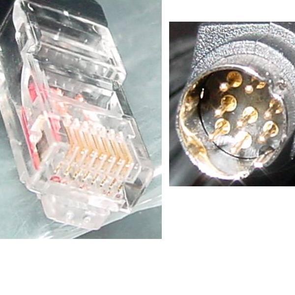

Hi again Mark:
Would you please tell me which is the function of each pin of the picture attached (rj45)? and what is the order of the pins in the connector minidin? (I mean what is number 1, number 2 etc) it is of a bose ps28
thanks for advancedUpload

Username: Phoenix79
Registered: Dec-08
Mr. Burgess, any chance that you could answer Horacio Alamilla G.'s question located here
Also what are the pinouts for the newer series III bass, the Zone 2 expansion on Lifestyle series 1 and the Boselink on the newer systems. I hope that you can help, and thanks for sticking with this conversation

Username: Mr3dzpop
Woodstock, Georgia
Post Number: 131
Phoenix,
Unfortunately I cannot find any information for the pinout of the cable... yet. I am still looking. As for the other stuff I must admit I haven't seen any of this stuff. I have not worked with Bose equipment in over 2 years. I am no longer in consumer electronics and have moved on to industrial electronics exclusively. Sorry I can't be of help. If I come across the cable pinouts I will get them to you.
Mark B.

Upon my arrival from a recent deployment(i am active duty U.S. Marine Corps) i turned on my system and got a very intermittenet sound. as i attempted to trouble shoot the problem, (checking speaker wires and connections at the media center) i noticed that the sound was getting worse (less and less sound) i turned the unit off and unplugged all of the power for 60 secods per the bose website and literature that came with the system. once i plugged the system back in, i was surprised to find, that i had no sound now.
Instead of relying on the s-video type wire that connects the media center to the bass module, i decided to use the alternate audio output rca jacks. The sound is perfect and clear as it goes thru the tv speakers.
Before it completely died thru the bass module, it sounded like there was one speaker wire that was either dirty, or loose. However, this loose/dirty connection was effecting ALL of the speakers at the same time.

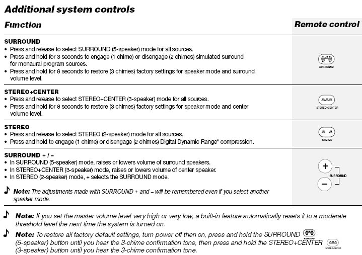

I'm trying to fix a Lifestyle 5 V2. Two issues:
1. The remote doesn't work. I have tried resetting it by pressing the store button while it is off and remote buttons but no luck
2. It is stuck on full volume. I suspect the button to turn the volume down doesn't work (can't check if it works via RC due to issue 1). I want to open it up and see if I can do anything but haven't figured out how - do you know?
Any help with either of these two probs greatly appreciated!
Thanks, Hamish
Username: Mr3dzpop
Woodstock, Georgia
Post Number: 135
Hamish,
Shake your remote! If it rattles or clunks then no doubt the antenna has broken loose from the PC board. Open the remote and resolder the antenna to the PC board and everything should be OK. If you are still having problems with the volume control then it could be that the volume IC is defective. This is a rare occurance so fix the remote first and then see if you still have no control over the volume.
