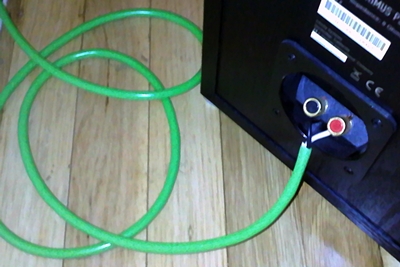

Okay, the RS I went didn't have the solid wire in the length I needed. I decided to buy the 12 gauge hook up wire. I am using ten foot for each run with gold plated banana plugs. Let me say that I can't say I could pick out the 12 gauge wire from the 16 gauge (Monster) wire in a blind test but I will say the bass seems fuller and deeper. It seems to be smoothe sounding too. This could be that these speakers are opening up as put more hours on them. At the least these wire sounds as good as the Monster. Now, I am going to try find some solid wire in 16 or 18 gauge and give that a try too.
Username: Mordecai
Texas
Post Number: 35
Registered: Jan-09
I am going to stay with either the 12 ga or 18 ga solid wire for a while. I would like to make them look a little better. I am thinking of using something like this.
http://cableorganizer.com/braided-sleeving/
What do you think? Any different suggestions or places I can find this stuff cheaper?

I'll jump threads, and update everyone on the Neon Green Utilitech 16/2 speaker cables I've been using for the last week or so. I'm still very pleased with the overall sound, I can easily live with these cables, even the look of them has grown on me a bit.
I still haven't tried the Belden 5000 cable yet.

Electric green.
Username: Exerciseguy
Brooklyn, NY
United States
Post Number: 2443
Registered: Oct-04
That would seem to be a bit more appropo.

I am going to look around for something else, CM, both sets of runs soud pretty much the same to me, with the biwire staying in.
I will look for a cable that does not strive to accentuate the bass and roll off the highs.
Cm, does your cable not have a green/ground/
The white lightnin cable used that conductor on the + as well.
Brooklyn, NY
United States
Post Number: 2444
Registered: Oct-04
Yes, The Mean Electric Green Cables are 2-wire cord. I think The White Lightning Cables use a 3-wire design because that was the only extension cord that came in white. And yes, I fully understand that in the end everything matters, so I wouldn't expect them to sound exactly the same to those of us with golden ears. That 3rd-green/ground wire must factor into the final sound somehow, but the 2-wire design sounds just fine to me.
The electric green 16/2 cord was 100' for $11. so far I've used 25' to replace the cord on my vacuum, and 20' for speaker cables.

Cm, your whole plce will soon look like it was decorated by the Green Goblin.
