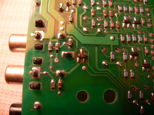

I'm wondering if you could help me recovering from a lightning strike that has damaged my Acoustimass module. The Acoustimass module is from a Lifestyle 20 system (serial number LSM20CU107173) and it is totally dead following a recent lightning strike. I have dismantled the unit and have found the damage on the "main" PCB. By "main," I mean the PCB that has the power connection, the output to the satellite units and the input from the music centre. On the underside of the main PCB, near the outputs to the satellite units, is a three terminal surface mount device. What's left of it looks similar to other devices on the PCB with "RA75" printed on them. This appears to be the only damage. Is it possible for you to identify this component and suggest a suitable replacement? I could email you a photograph of the PCB if that would help identifying the component.

Yes it would be helpful if you email me a photo of the board and a sense of just where this "component" is in relation to the board. From your description it sound like D412 but that really doesn't make any sense because that particular component would not normally be affected by a lightning strike. I can almost assure you that a single component failure is not what you're looking at. There will be other surface mount devices that are either shorted or destroyed and without proper testing equipment (a digital VOM at the very least) you will not be able to determine what is good and what is bad. There is also the path that needs to be taken into consideration. If the surge came in on the AC line then there are certain things that would be affected and if it came in from the console then the list will be different not to mention the possiblility that there may also be damage to the console. I know, it probably powers up ok but there is the matter of the 12v turn-on supply that needs to be sent to the sub to turn it on and this section of the console can go toes up in the event of a lightning strike. It would not affect the console per se but it would prevent it from controlling the sub. Send me the picture and we'll go from there. Sorry if this sounds daunting but lightning has no favorites!

Thanks for your prompt response. Photograph of the obviously damaged component attached :-) I've shrunk the photo to make it more manageable, but I do have 3.4MB version, if you need it. I take your point about the amount of lightning damage I may have had. I doubt if it is limited to just this component, or just the Acoustimass Module, but it seemed an obvious place to start. I plugged the music centre into another amplifier via the "Tape Out" RCA sockets at the rear, and the CD player and radio work perfectly. This, of course, says nothing about the interface circuitry to the Acoustimass module. I do happen to have a rather nice DVM, and a degree in Electrical Engineering, so I hope both of them may come in handy during this process.

OK, first of all that IS D412 and it's associated with your amplifiers. You are going to have to open up the amp portion of the sub and see what damage has been done to the amps themselves. That particular part is a dual diode and it sums the output of the two satellite speakers outputs in the DC and overcurrent detection circuit. You are going to need the schematic information on this one. The only way I can see that part being fried like it is would be if the amps failed. Email me and I will get the information to you. That above may not be the only problem you have but it's the most immediate.

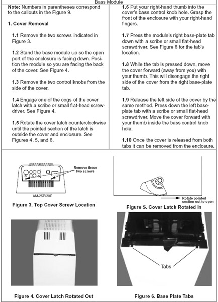

3) I can't get the case off. I remove 2 (that's all I can see) screws and the Bass and LFE knobs, but the plastic case won't budge. I am reluctant to pry too hard with my screwdriver. It looks like it should just slide off, but it won't.
From other posts it could be a fuse, a resistor, or a crystal, but I am confused as to which is most likely with my system.

At the top of this discussion thread there are two archived sets of 100 posts. Open the "Active through January 2008" and look for my May 15th post. From there on there are several posts containing exactly what you need to know. The May 15th post explains how to open the cabinet. Being an AM15, your problem is no doubt going to be either a fuse or the resistors. If you still have questions after that then I'll be glad to help.

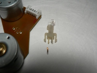

Username: Mr3dzpop
Woodstock, Georgia
Post Number: 86
Warren,
The problem with your sisters CD player is no doubt the small gear on the sled motor. That small gear meshes with a larger gear and that in turn moves the sled (the part the laser optics are mounted to). The small gear is a press fit on the motor shaft and over time the pressure of the press fit will cause that gear to split. This widens the teeth where the split occurs and the motor hangs on that spot when that section engages the larger gear. When there is finally enough motor current to overcome the catch, the sled jumps forward and the CD skips. Bottom line, that gear probably needs to be replaced.
Now for the matter of the remote. In a word NO! You could encode a remote with the BOSE codes but the CD5V as well as most all BOSE equipment uses an RF (radio frequency) remote and not an infrared emitter type used by most other electronic products. If you've ever noticed, you can control a Bose system from another room in close proximity without needing line-of-sight like IR remotes need. There are no programmable RF remotes that I am aware of.

Username: Frogmouth
Australia
Registered: May-08
I have an Accountimass 30 Series II from a Lifestyle 50 system. I have just had it repaired for a blown fuse and when I switched it on for the first time I seem to have blown the fuse again.
Rather than take it back to the repairer, who seems to take for ever, I would like to check it out for myself but do not know how to get the back off.
Can someone give me a few clues as to how to remove the back?
Thanks

Mark,
First, your help here is greatly appreciated as others have repeatedly said. The fluorescent display on my Lifestyle system continues to work well after replacing various electrolytic caps per your suggestion. An engineering buddy of mine tested the ones I removed and found one bad in the bunch. "One 100uf cap failed the ESR test with excessive reactance at 100Khz" is what he said.
I replaced a similar gear as you mention above on a motor that changes the CDs 2 years ago after I did my own diagnosis and pleaded with Bose to send me one. In anticipation of this happening again, have you found an after market source for this gear? maybe in metal like from a hobby store for radio control planes or cars, etc?
Username: Musicologist1964
Registered: Apr-08
Hi,
I had a similar problem with the small gear on the sled motor. After disassembling the music centre, I found, like you, that the plastic gear had split radially under the pressure of having been forced on the spindle of the worm gear, widening the gap between two adjacent teeth and causing CD playback to stall every now and then.
I fixed the problem as follows. I removed the plastic gear completely from the music centre and glued it back together with supa glue so it was back to its normal dimensions. I then used a small rattail file to open up the bore of the plastic gear until it could slide on and off the spindle of the worm gear. That is, the plastic gear was no longer under pressure when on the worm gear. I then cleaned the spindle of the worm gear spindle thoroughly and supa glued the plastic gear onto it. Since then, my CD hasn't missed a beat.
Hope this helps,
Garry :-)

Username: Mr3dzpop
Woodstock, Georgia
Post Number: 88
Ernie,
I am attaching an excerpt from the AM25II manaul on how to get inside the subwoofer. The AM30II is the same thing so this should help you with the puzzle box.

Username: Mr3dzpop
Woodstock, Georgia
Post Number: 90
Doug,
No I never looked for an after market source for the gear because the mechanism used for the Bose single CD players is the same part Yamaha uses in many of their CD players. I simply ordered them a dozen at a time from Yamaha. Somewhere in this myriad of parts I've accrued, I still have some.

Username: Mr3dzpop
Woodstock, Georgia
Post Number: 91
Warren,
If you got the other half off the console then you may have broken the little tabs in the back that hold it in. No big deal since the screws are really what secures the top to the bottom. If you will look on the back side (where the connectors are) below where you removed the screws holding the top on, you will see two small trapezoid holes about 1/8" to 1/4". Insert a small flathead screwdriver in one of the holes and gently push the snap lock back. Lift up on the side where you inserted the screwdriver until it moves up a bit and then do the same to the other hole. The CD cover, like the other half, pivots on the front. As I said earlier, if you break the tabs don't sweat it.
When you finally get access to the CD mech, on the right side you will see the gears in question. There are actually 3 gears and not two. (Again I made my statements from memory and was wrong) The two large gears simply snap onto their respective shafts and it's a simple matter to grasp the top of the furthest gear from the motor and pull it off. Once that's removed, push the laser assembly back out of the way and remove the second large gear. You can then pull the little gear off the motor. If it's indeed split it will slide off the motor shaft with relative ease. If it's not broken then it would have to be pried off with a small screwdriver placed between it and the motor. Of course if it's not split then leave it alone. Duh! Oh, and while you're in there, carefully clean the lens of the laser assembly. You may use a Q-tip with isopropyl alcohol or even a drop of window cleaner. Just make sure you get all of the junk off the lens. DON'T USE ANY OTHER SOLVENT!! The lens is plastic and some solvents will destroy it.
Email me with your Australia address and I will mail a couple of gears to you... when I can find them. I just went and looked and found one but I know I have more somewhere. I'll do some digging tomorrow and see if I can locate the others. I tried to attach the gear to this posting but for some reason it just won't stick. Hmmm go figure 8^)

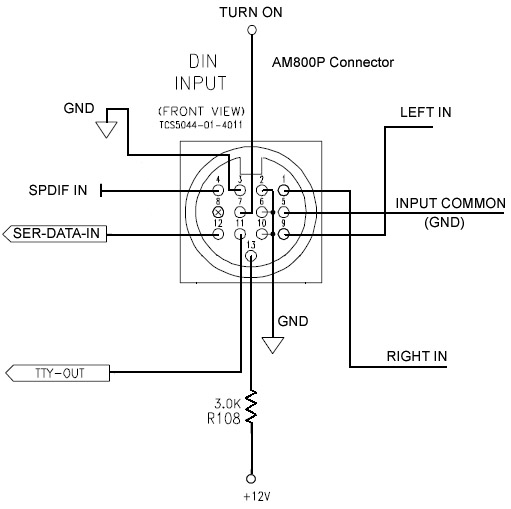

Username: Gonzilla5
Registered: May-08
Hello Mark. I'm a newbie to this post but your knowledge has already helped me. I recently bought a bose lifestyle 800 system on ebay. My problem is that it's missing the audio input cable. I was wondering if you have a diagram of the pins. It's an acoustimass 800 powered sub. Your help will be greatly appreciated and thank you for your time.
Username: Mr3dzpop
Woodstock, Georgia
Post Number: 97
Hector,
I'm attaching a diagram to the bottom of this for clarification. You will need a pair of shielded phono cables for the left and right audio inputs and a stereo 3.5mm phone plug and 2 conductor shielded cable for the control/data cable. The tip of the phone plug will connect to pin 12 on the AM800P din plug, the ring of the phone plug to pin 7, and the shaft (shield) connects to pin 3. For the audio cables, left signal to pin 9, right signal to pin 1 and both shields to pin 5. Also jumper pins 2,3,6 and 10 together. They are all ground but do not connect them to pin 5, leave that connected to the signal ground only. The other pins on the AM800P connector are not used by the CD5V2 which I assume you are controlling this with.

Mark,
Thanks for the offer of help. When the unit is first powered on, the CD mechanism will move to the 'home' position where it then makes the clicking noise as the gears continue to turn. It doesn't seem to register that it has reached this point, even though the toggle switch has been engaged. I looked closely at the switch and it appeared that one of the contacts was broken. I've attached a picture of the part that I unsoldered from the board. My thought is that this is the problem... the CD mechanism never knows that it reaches the home position since the contact is never made. Thoughts?
Username: Mr3dzpop
Woodstock, Georgia
Post Number: 103
Yep, that'll do it every time. Table of contents of any CD is at the very beginning of the CD (innermost tracks) and it is for this reason that the optical block goes "home" when powered up. Email me directly with a shipping address and I will dig one up for you and ship it. Simply replace the switch and you'll be good to go. Carefully clean the lens while you're at it and check the small drive gear on the sled motor to make sure it's not split. Might as well cover all the bases while your at it.
MB.

Mark, Could you help-me?...
I have a system 12 and been following your help you offer others..Mine is a simple question...
How do we open the litlle Subwoofer thingy ?
soI can look in on the Fuses ?
Thanks..
