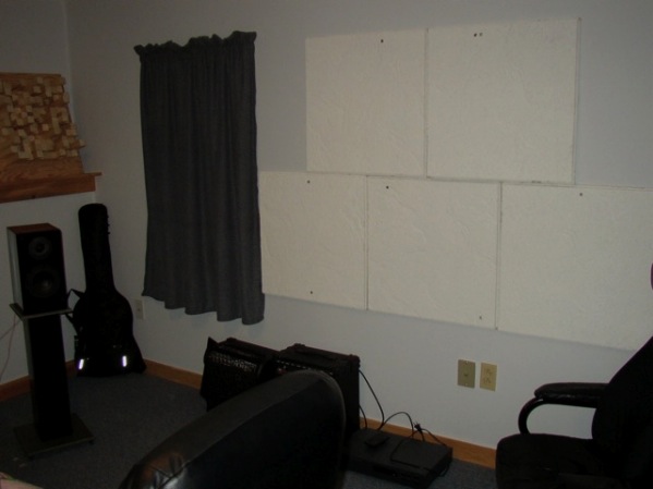

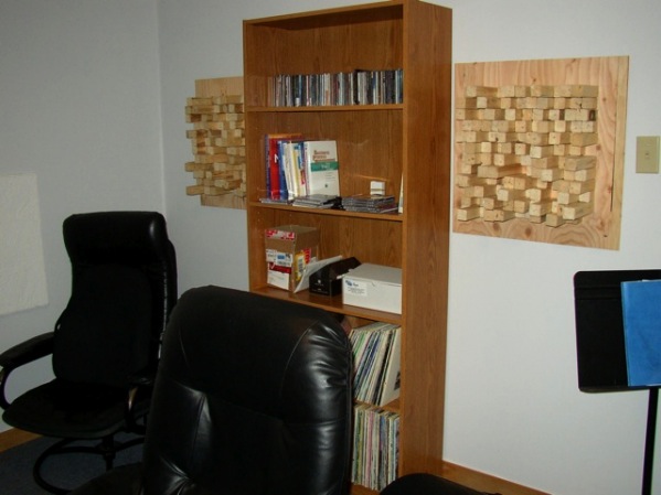

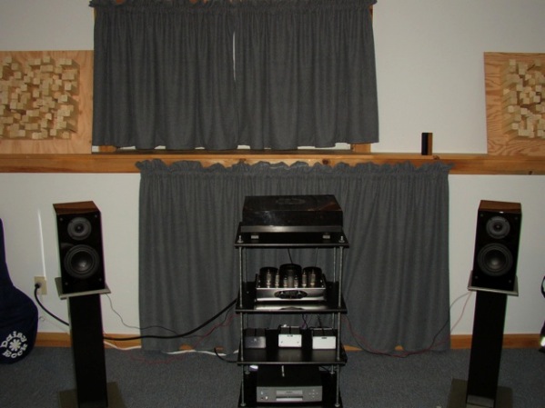

"Chris, I bought my Gallos on the word of my dealer as they didn't sound anywhere near as good in his set up as they did once I got them home."
I heard your speakers when you got them home. They sounded worse than that when you heard them in the shop?! GeezLouise!
Compared to where they are now after all the tweaking, they sounded miserable when I first heard them.

I like the speakers and the room.

"Compared to where they are now after all the tweaking, they sounded miserable when I first heard them."
Miserable to you was still better than what I had and better than the setup at the shop.
Granted everything is sounding nice now, better than even you might imagine with the speaker stands in place.
I had a friend over yesterday for some extended listening. The fellow is pianist, who said that George Winston - Into the Winter sounded natural, that the piano was not soft.

It took a bit of time to get things rearranged to make enough room for the Rega. I had to relocate my DAC, power supply, and Moon LP3 to an out of sight location behind the TV. I hate having hidden gear, but it was the only way I could make it work. However, I think I’ll be reorganizing again soon, as any step within a 5 ft radius causes the woofers of my speakers to travel significantly, sometimes accompanied by a record skip. I think I’ll be designing and building a new stereo/tv stand over the holidays.
As for the listening, well I got about 11 hours of play time through Saturday and Sunday. Saturday was painful. The sound was just not good. Harsh, no tone, very hot sounding. I assume it was the new cart and new rca jacks. Things started to come around on Sunday though, although still a little hot sounding. But the bass is coming around, there is now a little warmth to the midrange, and the soundstage is sorting itself out. I hear lots of potential. However I’m hoping there is lots of improvement yet. Not sure what to expect for a break-in period, but I’ve read up to 40 hours for certain cartridges. Not sure about the affect of the soldering the new rca jacks on. The phonostage should be well run-in, as it had been powered on at the dealers for weeks. I checked to make sure the table was level yesterday, and it was off by a bit so I fixed that. I used my Kimber PBJ’s between the LP3 and the amp, which had been idle since I had swapped them out of my digital front end in favour of Zu cables.
I’ll keep spinning vinyl and see how things come around.

Maybe a few photos will help.....
Front wall.....
Back wall.....
Side wall.....

Nice digs Chris.
I was just thinking, would there be any benefit to be had by painting those acoustic wall sculptures? Not with ordinary paint but with some automotive sound absorbing undercoating...possibly tar based? Might look neat as well, huh?
Your man cave is sharp. Got some dirty picture hidden behind those curtains? LOL.

By 'acoustic wall sculptures' I'm assuming you mean the lovely diffusors, in that gorgeous shade of spruce. I may paint them, but I don't want to put anything on them absorbent. I want the sound waves to be dispersed, not absorbed. And I want the sound of the spruce to be maintained, not hardened. I would like them to look better, but hey, it's an ear room first, and an eye room second.

So where I'm thinking about mounting the TT is on the front wall, just to the right of the window. If I put the phono preamp on the shelf, the interconnects should reach the amp.

I mounted the TT on the wall on the weekend. Home Depot had some very sturdy braced metal bracets that I sunk some 3" coarse threaded screws into. I had one piece of mdf from the flexy rack construction that I used as a shelf for now, which I fixed to the brackets with brass bolts and washers, with rubber washers against both sides of the mdf. It seems very solid. It's quite high in the air now....about 6.5', so I have to stand on something to put a record on/off, but that's no biggy.
It definitely sounds better. Bass is more solid, and more of it. More warmth in the midrange. Really good imaging. I finally have it to the point where I can sit and enjoy the music without being annoyed by something obviously out of whack. It's not where I want it yet, but it's miles ahead of where I was.
