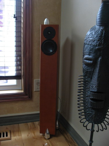

I had my Arro's always toe-in quite a bit. (Check out the picture) Just recently I have placed them straight. The are in corners about 10 feet apart, about 6 inches from walls. I think I like them better in this straight position!

That's awfully close to the side wall. You might find it works better a little further away if possible.
Glad to be of help by the way! Incidentally, I said start from straight ahead and then just toe in ever so slightly if the image is vague. If it's not vague leave them straight.
Also, if possible, place the Beak on the front outside corner of each Arro. It was designed to work this way best.

OK, Pablo, you got me confused again. You don't show the speaker toed-in so I assume you are just showing us a "before" picture.
Why do you like them in their current position? Ten feet between speakers is quite a distance in most set ups. Have you tried setting the speakers up according to a real plan or did you just place them where they fit in the room?
There are a few advantages and many very strong disadvantages to the placement you show in your photo. I suspect there is virtually no staging outside the boundaries of the speakers, center fill can be a real problem for most speakers at such a distance apart, the early reflections I can guess at would be destructive to three dimensional imaging and contribute to substantial comb filtering throughout the frequency range of the speakers to name just a few potential downsides to your inidcated placement.
Don't take the above comments to be negative but just as a recommendation to consider what you have available to you and whether another shift in speaker placement might provide further improvements in sound quality. One of the few upsides to your placement would be an increase in midbass loudness due to the proximity of all three boundaries within the room; floor, side and behind the speaker wall. Depending upon your room dimensions this is typically a boost that exists within a restricted region of the midbass response and can result in a rather exciting sound if the music you listen to is heavily weighted in that range. It can also result in a muddy bass that lacks detail and pitch rendition plus a lack of clarity through the lower midrange where many vocals exist.
If you haven't set the speakers up according to a plan, why not try one and listen for any benefits that might accrue from such a move?

Sorry for confusion. This is old picture when they were toed-in, and much closer to the walls, and my wife just did dusting so she moved the beak. The Beaks are on front out corners. Speakers are now about 6 inches from back and side walls and straight(paralel to side wall). I will make another photo when I get home. The reason for corner placing and so far apart is protection. I have 6 years old boy and as we know things happen. Just a week ago my friend's 8 yeard old son playing, of cause by accident :-) made a dent in 3 months old totem WIND! On top of it to hide the damage so both speakers appear the same he made similar dent in the other. If not a good suction of Mielle vaccumm my friend would have a heard attack.
later on I will provide recent shot and room dimentions. Also there are biamped with totem tress, and running on Arcam Avr350 and squeezebox as a source.

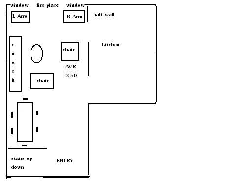

Quick update on room dimentions:
3.6m X 7m (living room part, kitchen bit more narrow and then entry, stairs ...)Arro's are on short side just 3 m apart 25 cm from side wall 20 cm from back wall. There are palm trees (thin ones) on sides, and side table in front of left one. Like I mentioned I had to hide them a bit.

Username: Jan_b_vigne

Pablo - Have you looked at any of the speaker placement guides I linked to?

yes I did but i am limited here by room lay out /furniture /my 6 year old son. This is really the best and safest place I can have them. I had them before on both sides of the couch but I find this is better. 80% is the bacground listening and when I really want to listen I use the chair that is in the middle between arro's and about 3 meters so it is fairly good listening position. The theory is nice if you can have one separate room designated but I have to make the best from what you can see. Puting Arro's straight I think did improve, I will play with sand loading maybe again to see.
