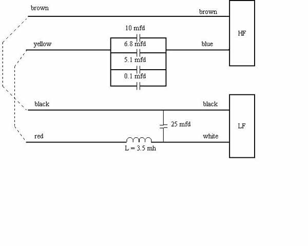

Simpler latter day crossovers slope at between 6db and 24db which means that if one drive unit fails, you may still get some sound from the other. However, typically, biwireable speakers don't use ordinary crossovers - they tend to use separate filters which should mean that the two networks are completely separate so there should be no sound from the 'other' part of the speaker.
That said, it does rather depend on the speaker design and if the manufacturer says it's normal who am I to argue?

"Simpler latter day crossovers slope at between 6db and 24db which means that if one drive unit fails, you may still get some sound from the other. However, typically, biwireable speakers don't use ordinary crossovers - they tend to use separate filters which should mean that the two networks are completely separate so there should be no sound from the 'other' part of the speaker.
That said, it does rather depend on the speaker design and if the manufacturer says it's normal who am I to argue?"
This has been an interesting thread with what would appear to have much misinformation and misunderstanding of bi-amping and biwiring.

Attached, please find sketchomatic for Magnepan MG1.6s.....very simple and when jumpers are removed, 2 separate circuits.
Also, what about amp Timbre? I didn't see that mentioned above. I could see (hear, actually) problems with say.....a NAD / ROTEL matchup.Upload
