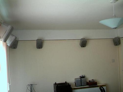

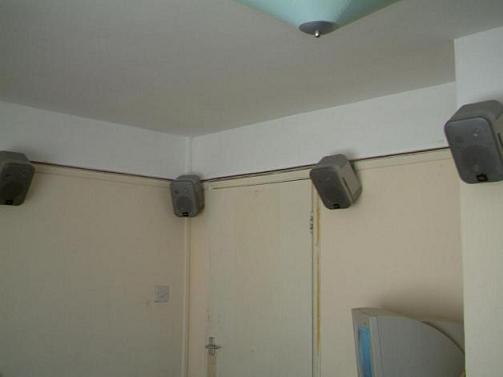

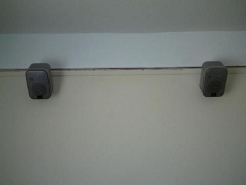

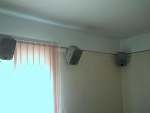

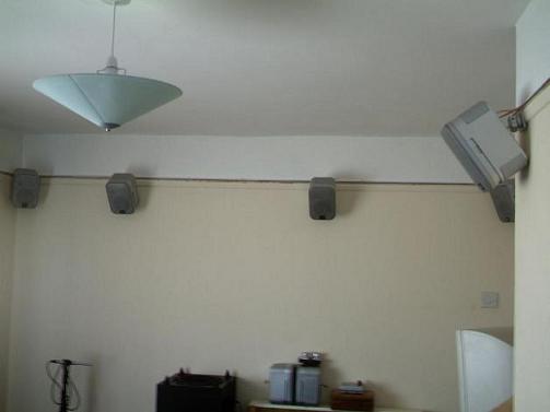

I run the JBL control exclusively for the surrounds while JBL control 5 takes control over LCR. The Control 1 add nice insane warp around so easy to install and I’ve forgotten which film adds the highest level in the lower end. They can’t reach down to far at high SPL db but with a little sub bass extension its seamless.
Around 80Hz upwards there good I’d hath to run further tests while LCR LFE.1 is muted.
Surrounds are wired in series and I’ve had no issues with there operating performance in the past 18 or is it 20 months now, hmmm, I forgot which year I bright them, think it was 2006?
In all there are x10 JBL control 1 x8 are fitted up at present and I still need to get at least another 10 or 12.

Reminds me a bit of Ashley's array.

Where is the rest of the kit???
TV? Rack? Front speakers? Center etc??

shouldn't those walls be padded and door knob removed?

Still at it huh Ash?
I bet it works great at any rate.
