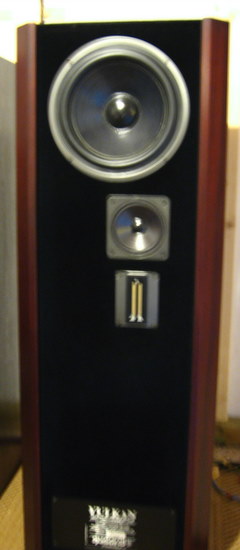

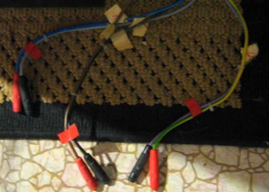

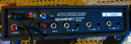

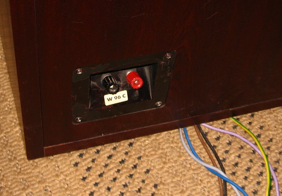

New guy here and not an expert - just a hifi nut who is in over his head on this one. I picked up a pair of Quadral Vulkan speakers (made in Germany - late 70's early 80s) recently and can't figure out the correct set up. They require active crossovers, which I have both of, but there seems to be more wires from the speakers than plug-in openings on the crossovers? Here's what I have so far: the c-overs are wired for 220v and I think I can solve that by using a step-up coverter or by just having a 220v outlet wired in by a pro. The speakers have the usual (1 red, 1 black) wire connections at the rear. Each speaker is wired independently with a total of six wires coming out of the base of each speaker (2 each for woof, mid, and tweet - 1red/1black). The back of the crossover seems clear enough where to plug in but there are not enough plugs. I'm assuming the three red plugs from each speaker plug into the crossover but what I don't understand is what to do with the black ones? So far, I haven't found anyone who can figure this out completely so if anyone is up for a challenge? Any ideas, theories, etc, would be very welcome. Needless to say I'm a little anxious to crank these up. I've included some pics that will hopefully give a clear idea of the situation. Thanks!Upload

You do not plug the XO directly into the speaker. What you have to do is the following:
You start with the output from your preamp. Right and left go into the inputs of your active XO's (right going to the XO of the right speaker, left going to the XO of the left speaker). The XO's then divvy up the signal into three parts per speaker. At that point you need three mono amplifiers per speaker. Each mono amplifier receives its signal from the XO and outputs into the appropriate range on the speaker.

You could always get three stereo amps, or a six channel amp, but one way or the other you'll need six channels of amplification.
As far as what kind of amp, it'd be hard to say without more specific information on the speakers (an impedance curve and phase angle plot would be useful in determining how difficult of a load to the amplifier the speakers would present). Without more info, all anyone can really do is take a shot in the dark.
However, since you asked for a recommendation, I'll point you to the Behringer A500. Its a decent quality (professional grade) stereo amplifier that runs about 200 bucks. And its German too!!!
