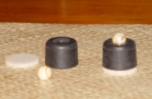

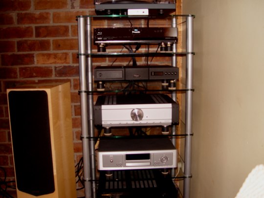

I have put together some cheap isolation/dampening feet for my CD5i and after finding these perform better than the squash balls under our components with our glass shelving, I am getting more parts today to make the same feet for the rest of our kit.
Each foot consists of a self adhesive felt pad, a rubber door stop (with a top recess for a screw) and a marble. The marble fits in the recess of the door stop, the felt pad goes under the door stop, and when put together the marble fits under the feet of the components, which I have found all have a small recess to hold the marble in place.
The CD5i in particular has within the recess of it's feet a screw head which grounds to the marble - in turn any vibration entering the marble should be absorbed into the rubber door stop and any upward vibrations on the glass shelving should be dampened by the felt pad and door stop to prevent entering back into the components. That's my theory and it sure seems to work well - at least it does on the cdp. More high end detail, cleaner more spacious soundstage, tighter and deeper bass. Enough to stop me wondering about a CD555 (grin).
Pictures coming soon
Please post about your isolation devices with pics (if possible) whether DIY or bought. It may help others find what may be suitable for various components and shelving material etc.
Thanks to Mike Wodek and Jan Vigne for putting me on this path.

LOL! No - really I don't. I think I have moved in a far better direction music wise, but it has had its price. Mrs R would probably be happier if we stuck with the original stuff as supportive as she is.
The squash balls work to a degree and I think if the shelves were thick timber they may have been enough. But the bits and pieces seen below with our glass shelved rack (which is on adjustable feet, not spikes) seem to do the trick - at least as far as I can go without upsetting my better half.
Cost for each foot about $4.50 (still too much, but nothing cheap here).
BTW - the cabling disappears under normal lighting conditions - looks damn awful with the flash.

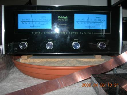

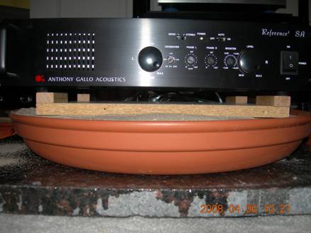

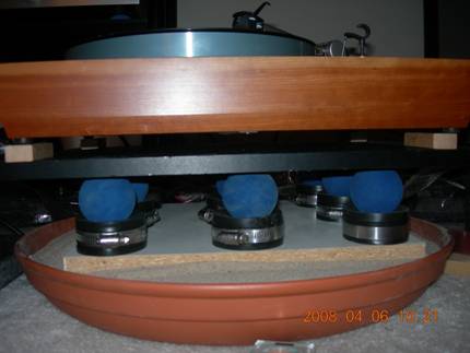

M.R. - A couple of us were discussing Constrained Layer Damping
http://www.google.com/search?q=Constrained+Layer+Damping&ie=utf-8&oe=utf-8&aq=t& rls=org.mozilla:en-US:official&client=firefox-a
The first thing I would do, having done it myself now, would be to do some dense damping with the TT. I moved mine to the floor, well a about 1 1/2 ft off of the floor with isolation and damping under it, but that was what a Linn needed, not sure about other TTs.
The tennis balls, racket balls, neoprene plumbing end caps, Jenga tiles, and Black Diamond Racing Cones I have used all fit in the "isolation" bucket.
I have been steered toward damping recently and found that for my amps, damping works best, for my Linn, a combination of damping and isolation works best (it no longer bounces around Nuck), and I have left my pre-amp, CD player, and tuner with isolation only, much as you have with your set up M.R..
I just made additional changes yesterday to the amps and TT so I am not going to experiment with damping on anything else right now as all of this sounds too good to mess with.
BTW I like the idea of using each device's feet in the equation. That is what I did with my Pre-Amp, but then I added one more racket ball and neoprene cap (slightly taller) each under the tube and phono stage sections directly. I will try to get some pics up here sometime today.

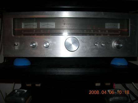

Username: Mike3
Wylie, Tx
Post Number: 1229

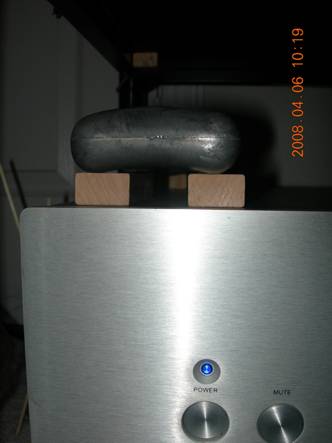

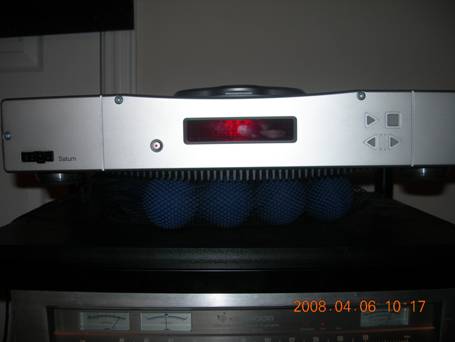

Saturn
Kenwood

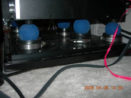

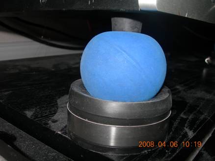

Isolation for Pre-amp
Dampening for Pre-ampUpload
Complete Pre-amp isolation
MAC CLD Set Up
Anthony Gall S/A CLD Set up
Linn CLD with Isolation Set Up

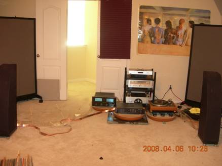

The "New" new look

Awesome pics guys. M.R. That appears to be a Panny blu-Ray, when did u invest in that?

Mike - from construction site to Japanese tea garden. And I bet it sounds as sweet. Great pics and thanks for that link - I'll read some more on that. I almost bought those same balls at first, but knew I wouldn't get away with them - so I got the squash balls. But these MR-feet (I'll have to take out a patent ha-ha) seem to do the job nicely. Mrs R commented on how nice the music sounded. At least I put those few loose marbles she said I had to good use.
Oh, I took away the timber base for the T/T as I found in the packing box some little metal discs for the coned feet. I packed blu-tak under the discs and mounted the coned feet of the T/T on them and there was no difference than having it on the timber base. I know it could benefit from further isolation as you suggested but it does okay without upsetting the aesthetics (read Mrs R).
Maybe the BD player could benefit from a little weight on top. The top panel of the A5 is a bit ringy with a finger nail flick, but I tried a reasonably weighty book but noticed no difference so maybe the feet work with that also. I got the Panasonic BD player a little while back Nick - great picture and sound abilities. Also does very good DVD-A.

"I moved mine to the floor, well a about 1 1/2 ft off of the floor with isolation and damping under it, but that was what a Linn needed, not sure about other TTs."
If my memory serves me correctly, Linn has advised this as optimal placement for the LP12 for a very long time. No idea why. I think it was Jan who said people theorized that it was Linn's way of getting you to kneel down in front of their turntable. I've heard that from a few others as well.
Rantz,
Your contraption remind me of Vibracones. Have you tried yours with the marble side down? Vibrapod (maker of Vibracone) states to try them both ways and see which sounds better.
Vibracones, and Rantzcones, side by side...
UploadUpload
Username: My_rantz
Australia
Post Number: 1895
Stu - Thanks fir the pic and idea. I've seen the vibracones and vibrapods. Here they are about $11.00 each. As far as trying the Rantzcones (I like that) marble side down, it may well be benficial though the components would move with the slightest nudge. I may substitute the marbles for steel balls at some stage if I can obtain some cheap enough.
Now that I have listened to much more music since I have tried this, the more satisfied I have become with this tweak.

"As far as trying the Rantzcones (I like that) marble side down, it may well be benficial though the components would move with the slightest nudge."
On glass shelves, it would probably walk off by itself. On another surface, possibly. It seems like glass shelves may be a more challenging surface to try and dampen than other materials?
How soft is the rubber on the door stops? I recall that type being fairly hard. Vibration dampening can be solved theoretically for machinery and structures. This is often highly dependent on the spring constant of the dampening material, another way of describing how soft or hard it is by measuring how much force it takes to deform it a given amount. More specifically, it is the spring constant in relation to the natural frequency of the supporting structure and the exciting frequency of the equipment. I've encountered this is my engineering work. Audio applications, on the other hand, are on a micro scale and have many variables, explaining the need for a lot of experimentation to arrive at the best results. Interesting thread MR.

Neil, the door stops are reasonably hard, but do have a little resistance. Yep, one could experiment for weeks with different materials except there's a point where one may really lose his marbles - if you get my drift. At this point they seem to work fine, Maybe if I get another bright idea using cheap materials I may try something else.

Ooops, forgot to mentions that my Rega Saturn, with it's under-chasis heat sinks; gets the same as the turntables.
