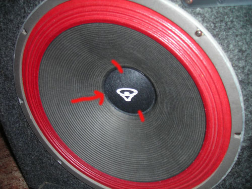

Ok, I don't know too much about speakers, subs, or anything. All I know that since I've been a kid, these speakers have been my dad's pride and joy. Every time we have a party he busts these puppies out and rattles our house.
The other day I decided to have a party while my dad was away. In a slightly "influence" state, I was showing off the subs to a friend and I put my hand on the sub while it was thumpin'. To my horror, the sub all the sudden started making a very raspy sound. The next day I took a flash light and examined the sub. My friend said that I probably cracked it.
Upon further investigation I found out that the center of the sub with the Cerwin Vega! emblem was messed up a little bit. I tried outlining the area in Photoshop. There's no cracks, but it's almost like the lining where the middle emblem material connects to the ribbed part of the sub flexes. It barely moves and the sister sub we have doesn't do that, so I'm assuming that's what the problem is.
Pretty much my problem is this: as I've said, these are like my dad's pride and joy. I don't have a steady job right now, but I might be getting one in the future. Is there anyway to fix this sub without doing more damage? The picture literally shows everything, I took a bunch but there's nothing like noticeable about what the problem is. You'd have to hear it.

Nick, these speakers are incredibly robust. The damage indicated to the dust cap is unimportant. However, the phase plug behind the cap is important, this may have been disrupted, although I doubt it.
I once punched a 15" CV woofer and did no harm. Similar state, a long time ago.
Should be no harm.
And quit screwing around with somebody else's stuff, it might not be forgiving Dad next time!

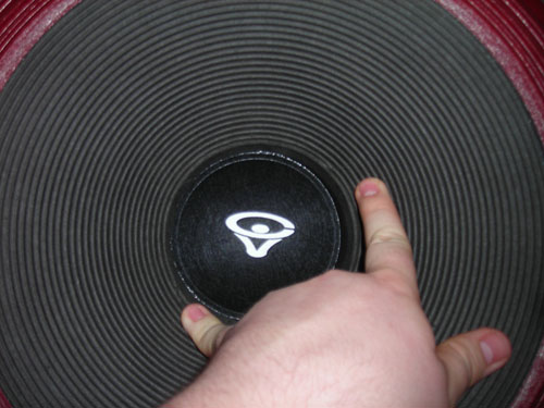

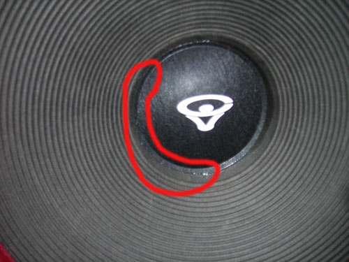

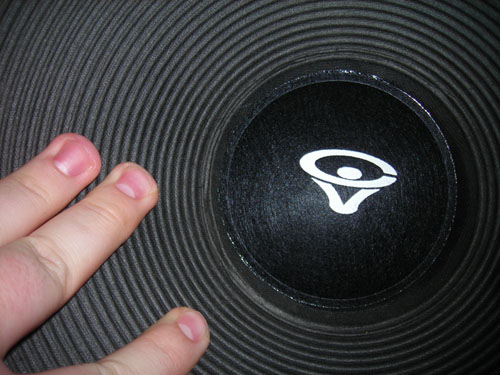

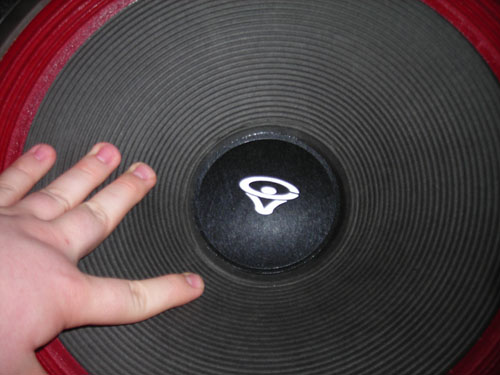

Ok well, seeing as Nuck must have signed off, this is what I've come up with.
I unscrewed the subwoofer from the box and examined it with a flash light. Nothing looks out of place. I found nothing that looks like a plug except for the positive and negative wires clamping onto their correct parts of the sub. There was no tears or marks on the underside.
Anyways, I went back to what I had originally thought. I took more pictures and, I might not know anything about subs, but I know that this definetly looks out of place. There are major bends where the dust cap connects to the ribbed part of the sub. I wish I knew terminology.
The picture with me spreading out my index and pinky fingers was my feeble attempt at showing the distance of the bend. The semi circle above my fingers indicates the length of the bend. It's the first rib there is, directly where the material of the dust cap connects to the rest. The part that you can't see in which my hand is covering is a place where there is a slight bend, but it's on the second rib up. The first one is solid.
The only reason I keep coming back to the subject of this bend is because the other sub we have has no bends whatsoever on it.

These aren't "subwoofers" and there's no "phase plug" in this driver. To be honest I don't exactly see what you are describing when I look at the pictures. From what you describe you probably bent the edge of the voice coil. There's no way for you to repair this yourself. Just tell your Dad what you did and offer to pay off the cost of the repair. Anything you attempt at this point will only make things worse.

The dust cap may have come loose if there's no scratching when you push in on the sub when there's no current running through it. If you heard scratching in the sub at any volume the voice coil might be bent. You said LOUD music is what makes it sound distorted, you said you touched the sub when it was playing maybe somehow you knocked the dust cap loose and that's why you only hear distortion when the speaker(useing that in a general sense, they're all speakers) is really thumpin. Just a guess.

I've inserted a diagram for you. I found this site for you, not sure how these prices compare to the local place you're going to bring your dad's woofer but it may help. You may have to bring the speaker to the rapir shop to be sure what's wrong with it. What i would suggest doing before you go to the shop is get the model number of the woofer and get the price of it, compare it to the price of repairing. If it's an older model it may be cheaper to just buy a new one. Upload

Jeff, thanks for the diagram. Where the dust cap connects to the cone is where I'm having my problem. It's the ribs that go around the cone. The first rib that connects from the dust cap to the cone is what's damage. And tell your friend thanks, but no super glue should ever touch this woofer. One of my friends already said that but I'm too much of a chicken s**t to try something permanent like that on my own.
