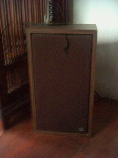

In the photos you can see the full speaker (there are two) the BMI logo (in case that sheds some light) and the black thingy in the back, the red thingy in the back, and what I call the mute button, which functions to turn the speaker off, as far as I can tell. I use this generally has a method of trying to jumpstart the speakers when they are acting up, which is usually a very temporary solution.

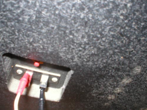

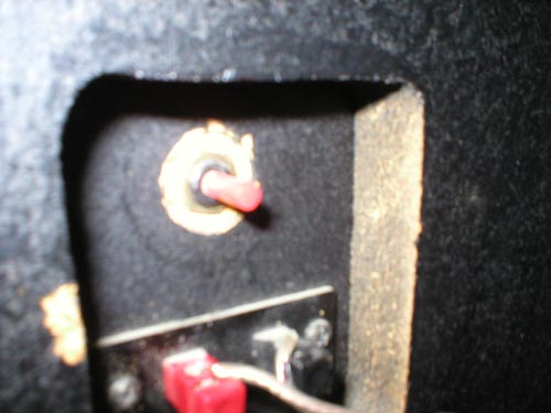

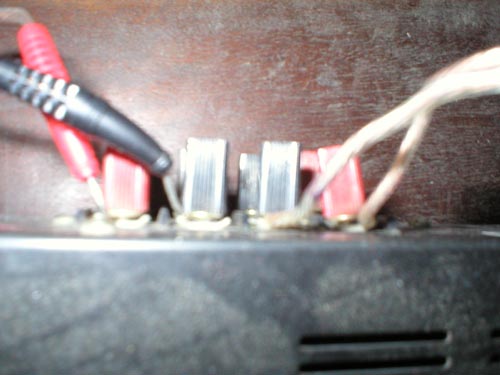

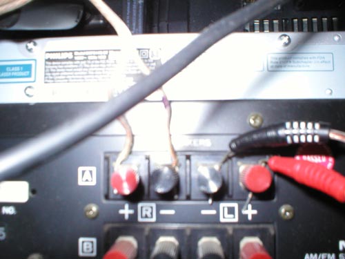

Username: Szelitch
Registered: Feb-08
Here are the hook-ups. That's copper wire I have leading from the central source button box thing (second and third picture) and then the left and right speakers (first and fourth).
Username: Jan_b_vigne
Dallas, TX
Post Number: 12330
Registered: May-04
I think the red button on your speakers is a reset for a circuit breaker type tweeter protection and is not a "mute" button.
Your description and the pictures would lead me to think the speakers don't like music with heavy bass and you're probably playing them with the amplifier well into clipping. Since they were free I assume you won't be too insulted if I say these don't appear to be terrific speakers. You haven't given a description of what's wrong when heavy bass is played through these speakers, so how about telling us?
