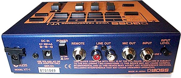

By the way here is a picture of the voice transformer:

Thanks, but the problem is that in the manual there is an arrow from the R L out's you can see on the pic to a textbox that says "Amplifier" I don't know if they mean that I should connect them to an amp in order to work? I don't want to buy the wrong cable, I mean it's better to buy an amp if it's necessary than buying a direct connecting cable that doesn't work :-/ (an R L to 3,5 mm jack cable).

But I don't understand why the there is an arrow from the output of the VT to a box saying "Amplifier" in the manual. :-/ Maybe the PC's own "amplifying" is enough? (Because I think the VT was designed for old tape recorders since it was invented in 85 or something).

The arrow is there to indicate connections for playback not recording. You don't need the amplifier for recording. Try recording using the unit without the pre amplifier feeding the pc. Only add the pre amp if you cannot get sufficiently clean recording levels with the unit straight into the pc. Adding the pre amp can overload the pc's recording capabilities so try the simplest route first.
