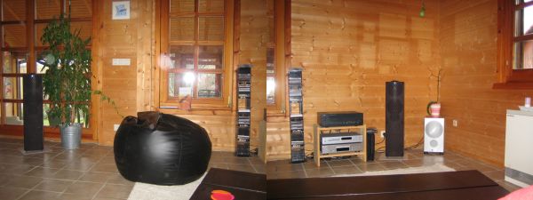

I changed the position of the sub towards the right corner...very big improvement!!!!
PUNCHY!!!!
Very strong and clear punch-bass...I had to turn the volume down pretty much. Corner effect?? Sure is.
The phase is on 0° and its running on 85.
Great improvement so far....

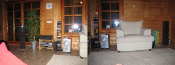

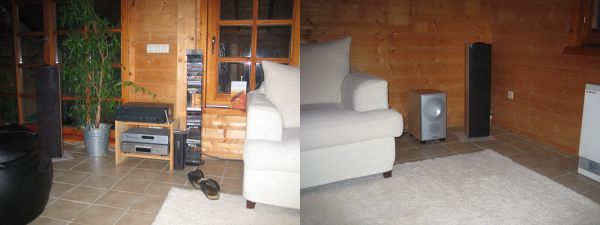

Try swapping the location of the speaker and the sub.
Username: Luxendel
Gondelsheim, Baden-Württe...
Germany
Post Number: 43
Will try...
Reason is?
Username: Jan_b_vigne
Dallas, TX
Post Number: 12174
Registered: May-04
You'll probably still do better with the subwoofer loading directly into the 45/45° angle of the corner and the speaker should sound better overall when it is out of the corner and away from the sidewall. Put "loudspeaker placement" in a search engine.
Username: Luxendel
Germany
Post Number: 44
Just did as adviced!!!
Again lots of improvement!!!
Thanks, Jan.

Username: Nuck
Post Number: 9716
Registered: Dec-04
The pics in this thread are really helping, TL.
Username: Nuck
Post Number: 9717
Registered: Dec-04
That is a very good looking room, to me.
But a very hard and reflective room to listen in.
Username: Luxendel
Germany
Post Number: 45
Hmmmmmmmmm, could u be more specific Nuck?
How you mean "hard and reflective"?
Because of the wood and the tiles?
Right now, the sound is INCREDIBLE.
Fat as hell, crystal clear...the bass is so frigging tight...cool.
I do not hear any bad "reflective" sounds.
Its not muddy at all.
Removing the custom-bridges from NAD from main-in to pre-out solved the little harshness in the treble-area.
The whole whouse is made from wood.
Its the only room I can use for listening.
I know...the room is a uneven square.
The HIFI-system is in the second half of the room.
The whole room is apprx. 11m x 5m...
To me, all is fine...
Better it can always get...
